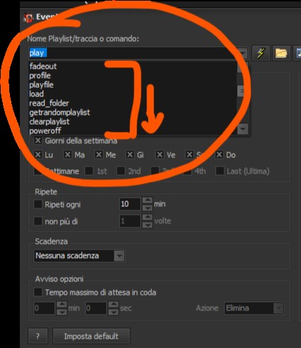

1. for the WIZARD I wanted to understand the use of the "all" commands of the panel on the left (see attached photo)
That list includes the most commonly used commands. For the rest, you should copy them from the user manual, given that most of the commands require parameters, so user manual will be used anyway.

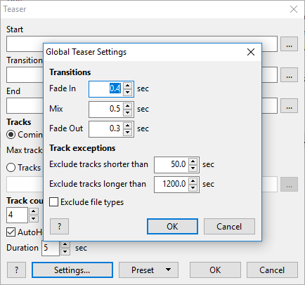

You can edit transitions in the teaser itself: in the Add Teaser window click Settings, and set the transition parameters to your needs. See the image attached.
If you want to edit how the teaser itself is mixed with preceding or following item in the playlist, then you need to create a file type for teaser (actually, the default file type already exists, named "Teased" but that depends on when you first installed RadioBOSS, it didn't exist in older versions).

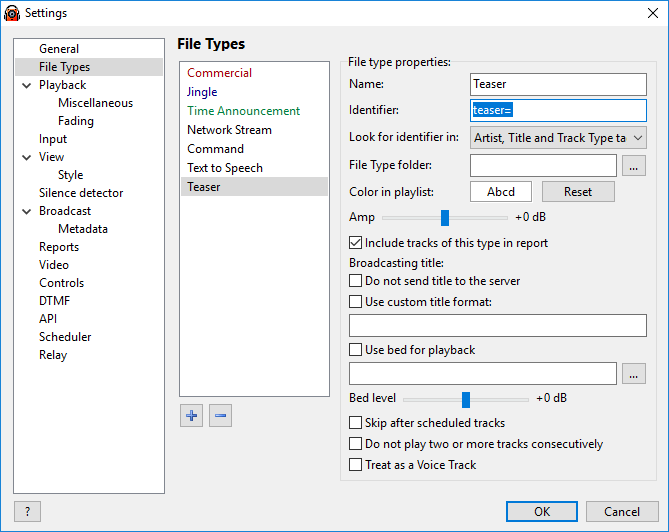

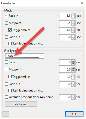

Creating a file type: https://manual.djsoft.net/radioboss/en/using_different_types_of_files.htm
Set the identifier to teaser= in the settings (please see the second screenshot).
After file type is created, edit its mixing settings in the crossfade settings for that file type: https://manual.djsoft.net/radioboss/en/crossfades.htm - please see the third screenshot.
and is not it better a wizard with the instructions that guides you step by step?
