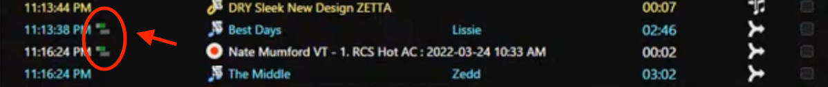

What about the case when those items are scheduled? Should they have the "Clock" icon added to them (as it happens now with "Music note" icon) or should just those custom icons be used?
I think it should stay as it is now.
To differentiate, I’m not sure if it would be better to use an hourglass icon or some other icon that indicates that there are scheduled items. But for me, it’s fine the way it currently is.

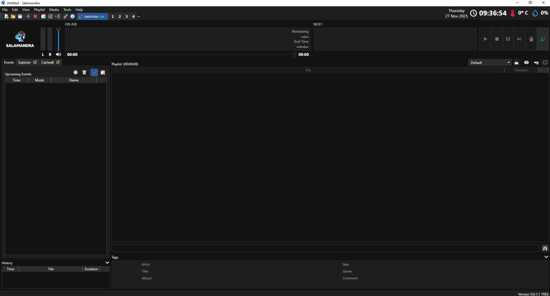

Some ideas can be taken from this software called Salamandra. It’s still in development, and it’s inspired by Radioboss and Zara Studio.
I like its visual interface, which is NOT very different from RADIOBOSS. I think we could take some ideas from this software because it looks very good visually.
Specifically, the way the current track, the time, the date, the temperature, and the humidity are displayed is very well organized.
Additionally, some icon ideas like these:
The interface is a copy-paste of RadioBOSS 🤷‍♂️ (and, like any software today, is black). Minor changes here and there, but this is a copy still. I honestly do not see what is "new" here, moving the temperature from left to the right in certainly not an innovation.

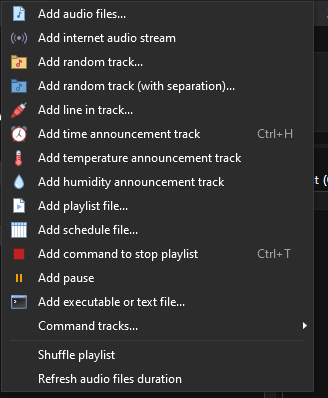

Well, menu icons for every command is what was in the UI design guides in the beginning of 2000s. RadioBOSS also did use menu icons in the past; nowadays it looks bloated and outdated - and, in most cases, those icons do not add any additional value/information. E.g. on your screenshot, "Add random track" has a folder with a note icon - how is this associated with randomness?
But I agree some more UI icons, like for weather display, can be useful and refresh the UI. Maybe for certain menu commands as well. Or custom icons for playlist/zone tabs.

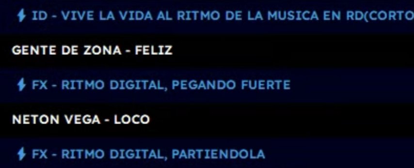

I think it could be tried. I currently use emojis, as I show in the screenshot, to distinguish the items, but they don’t display in color. Also, in each filename I have to add an emoji to tell what type of item it is. Doing this is a bit annoying because it takes a lot of time.
I think what you’re suggesting would be fine. In that case, they should be configured for each file type, and Radioboss should already have the corresponding icons set by default.
Yes, that’s true. But I think the empty spaces at the top of the interface could be used; placing the time and date in a larger size would look better for the user
The menu icons certainly aren’t necessary — I was referring more to the idea of icons that can be used for the items; I didn’t specify that, sorry.
Support for color emojis may also be added, I marked it for RadioBOSS 7.2.
Yes, ready icons, as it would be pretty inconvenient to load your own icons.
