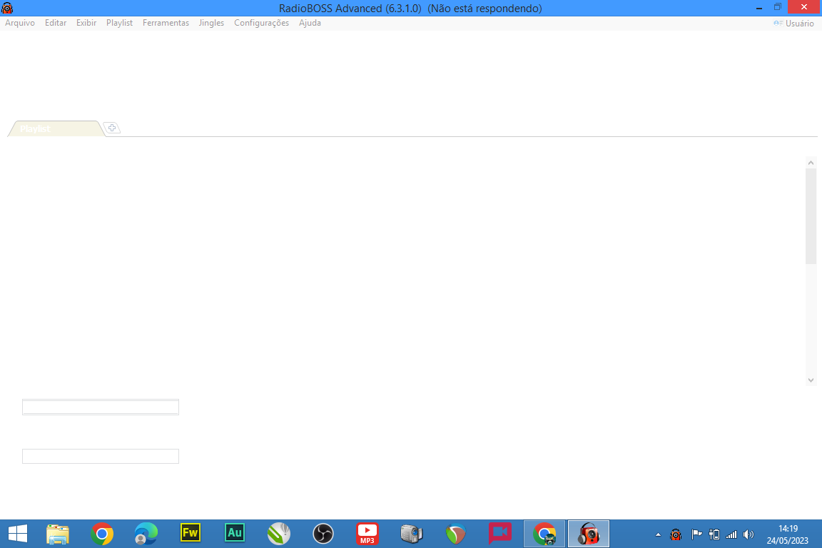

After update from 6.3.0.7 to 6.3.1.0 i have a white screen, then Radioboss closed and reopened over and over with the white screen again
Mine was working fine see other thread back up before applying update all is good on our as you an see our stream is playing on 6.3.1
if i reinstall radioboss 6.3.1 completely it starts normally but as soon as i restore the settings from 6.3.0.7 nothing works anymore

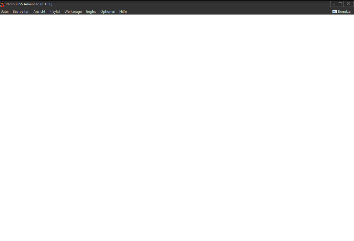

I have exactly the same problem the studio restarts infinitely with a blank page (6.3.1.0)
I had to go back to the previous version...
i have tested a little bit, i think the error is related to the profile folder
I have made a clean installation
Then I replaced the style folder with my old folder and changed the style.... no problems
now the player ini and player ini bak replaced with my old... no problems
now replaced the profile folder with the previous one and nothing works anymore
so the error is that the profiles are not taken over in some cases
