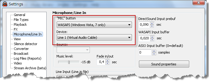

III. Setting up RadioBOSS
In RadioBOSS, enter Settings->Microphone/Line.In. In the "MIC" button settings select
Device: "Line 1 (Virtual Audio Cable)"
Now, when you click "MIC" button in RadioBOSS, you'll hear the Skype conversation. When there's no Skype call, just microphone will work.
