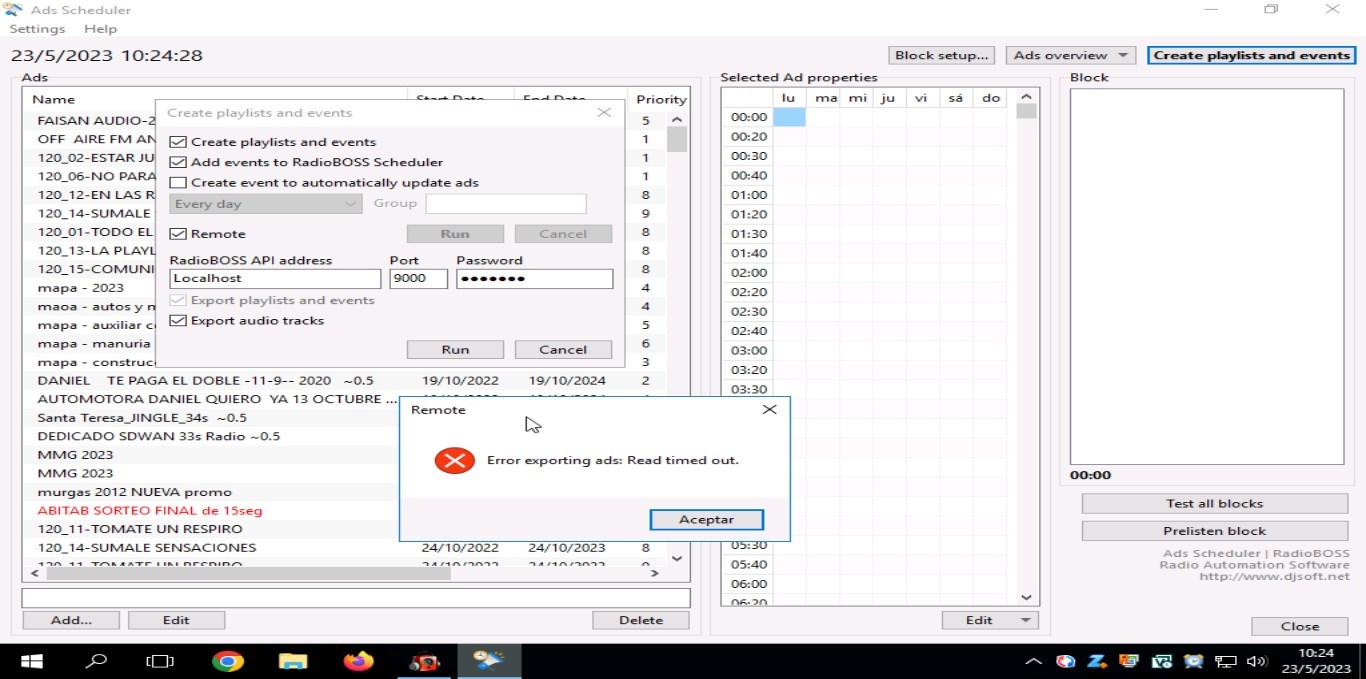

I'm testing this before getting it up and running (RB 6.3.1):
"Fixed remote ads management when "Pack as container" option was enabled"

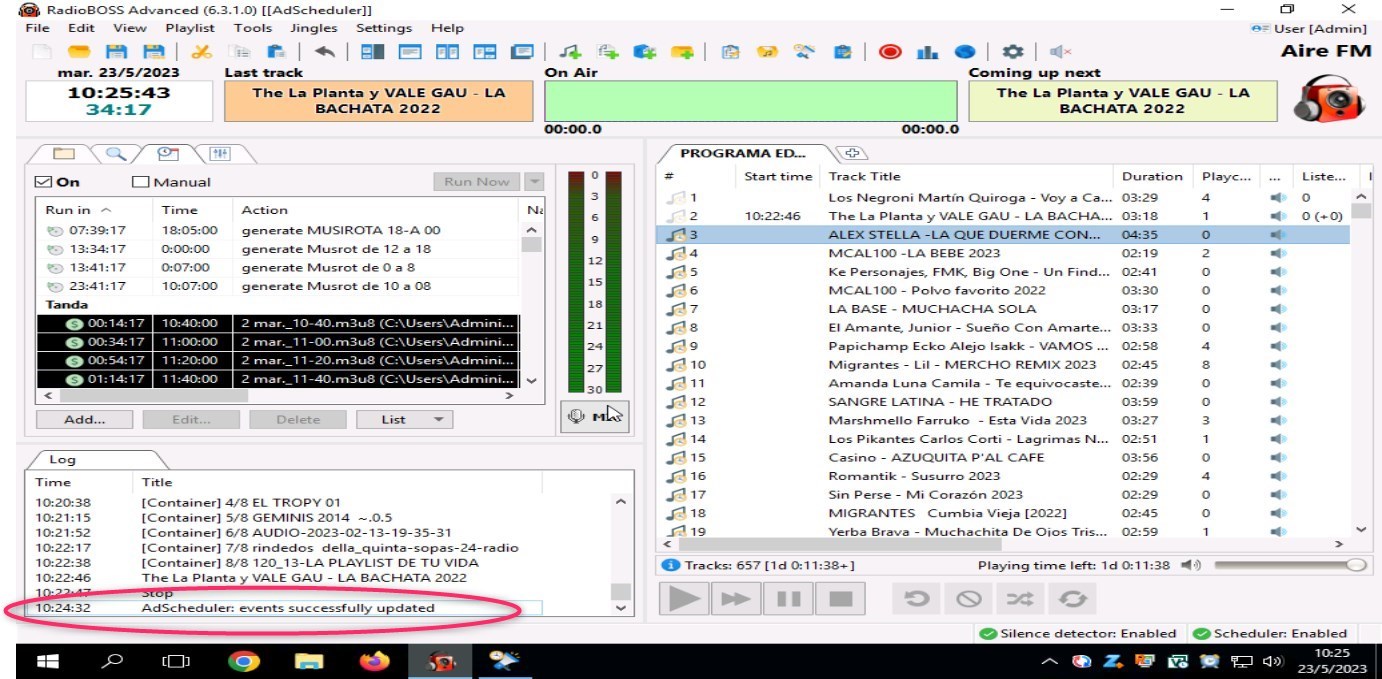

and it produces an error, anyway, the events are generated well, even in the log it appears 2 times its execution.
This test is to Localhost but using remote
The other thing I forgot to mention is that it takes much longer than the previous version.
But the time difference is very noticeable!

When I click to export the audio tracks, it takes between 5 and 6 times longer than version 6.3.1, it ends up giving the mentioned error and in RB after a couple of minutes the events appear and the log says that everything worked fine .
If you consider, you can connect with Anydesk and see the behavior.
The problem is even more serious, I just did a test without the container option clicked and the error occurred again and it took a long time to finish!

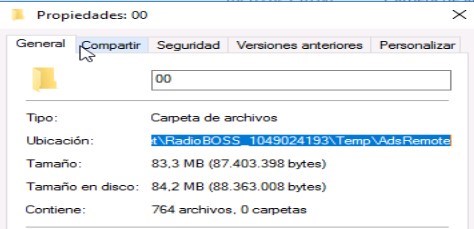

Looks like you have a lot of audio data. Please click Settings->Open Settings Folder menu command, open Temp folder, how large is the "AdsRemote" folder?
I don't think it's too large, but nevertheless, version RB 6.3.0.7 works perfectly fine. It's fast and no errors appear. The problem with that version was the container packaging when sent remotely.
