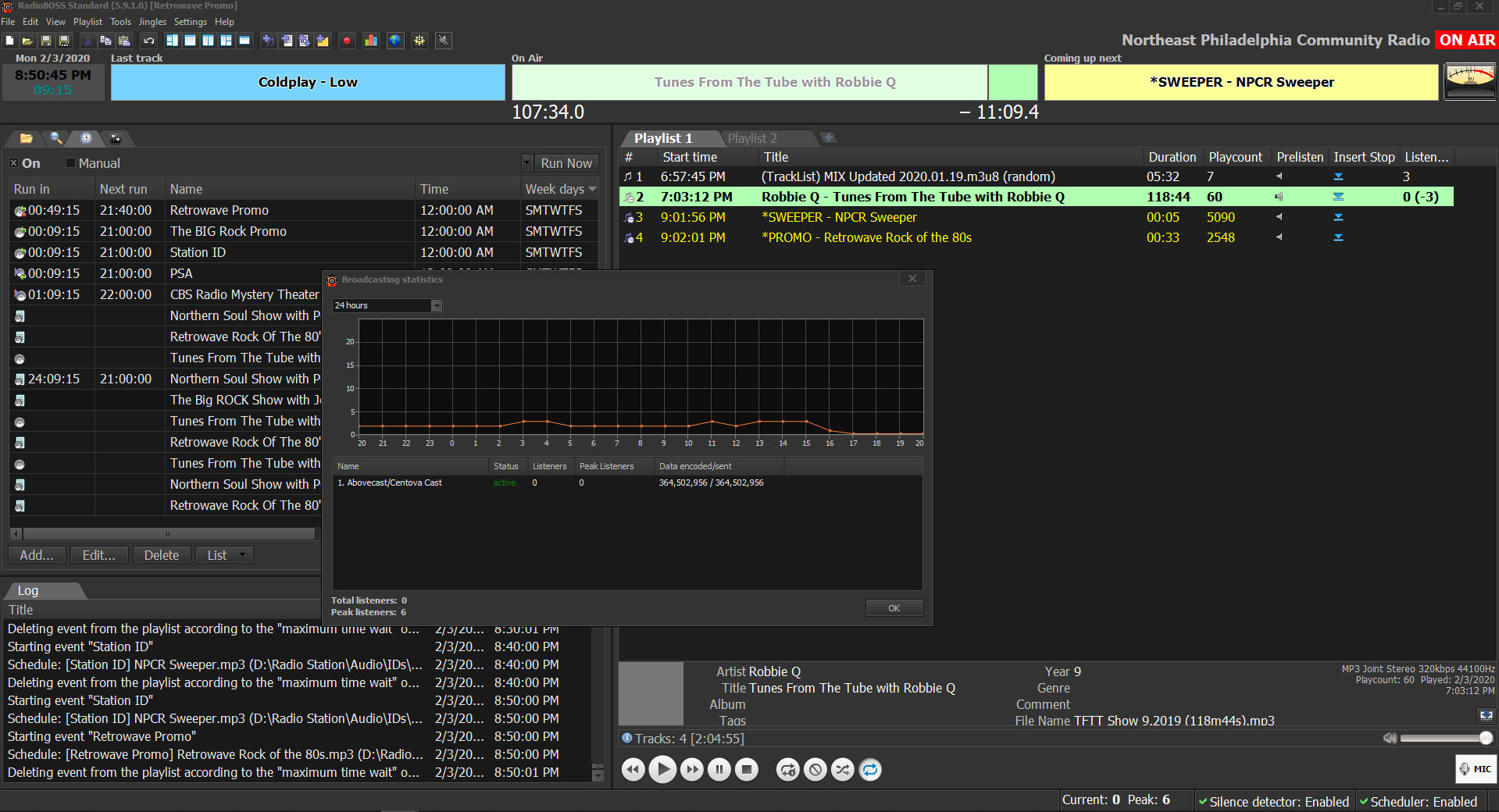

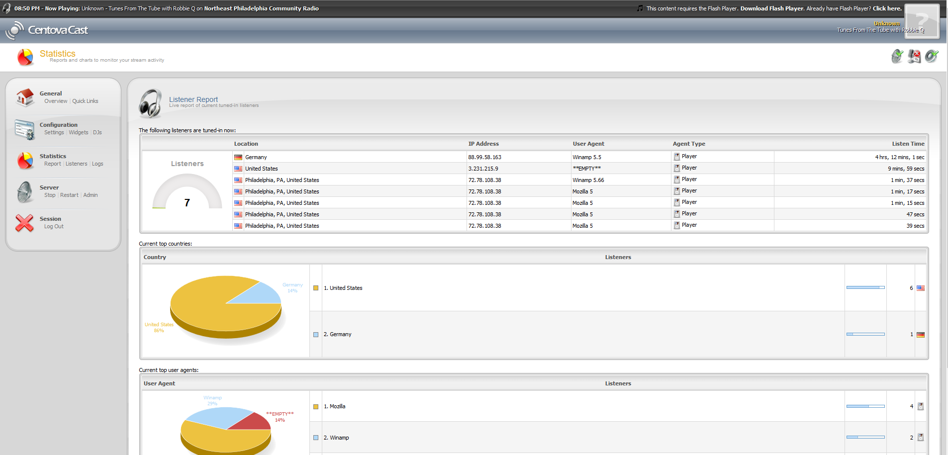

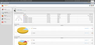

Hi Dmitry, This is a bug that I noticed in RB 5.9.0.9 and also in the 5.9.1.0 update. The Broadcast Statistics does not read correctly or freezes. I also opened the Broadcast Statistics from the Tools menu which read different from the bottom. I confirmed this when I opened my Centova Cast panel. It shows 7 listeners and 0 on the RB statistics. I was hoping that it would be fixed in 5.9.1.0. Thank you. C.J.
Please contact our support with details (server address, port, password) so we could check what's wrong there: support@djsoft.net
Note that typically Shoutcast server requires admin password in order to retrieve statistics, in this case, please specify admin password in statistics relay: https://manual.djsoft.net/radioboss/en/statistic-relays.htm
