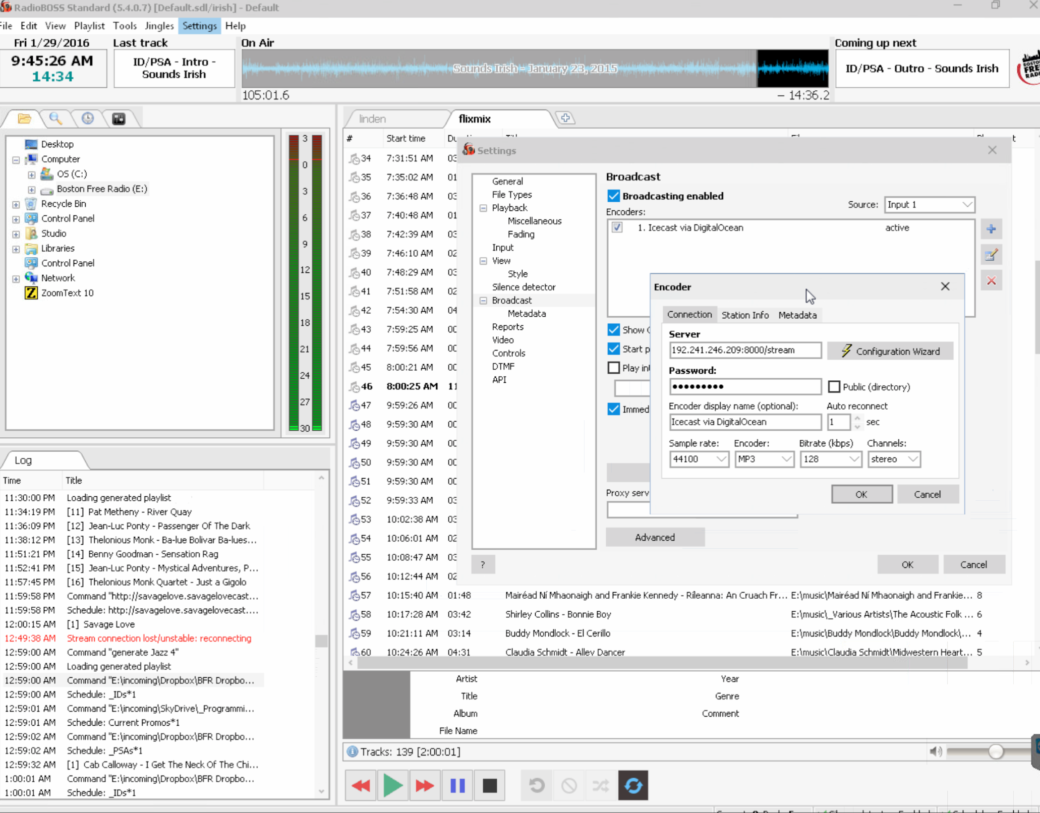

The broadcast will connect and work fine, but occasionally drop out and never reconnect, and not give any helpful reason why (details in the screenshot).
We are using the default IceCast setup where there is no real initial "mount point", meaning "/stream" gets created on the first connection to :8000. That might have something to do with it. I know if I enable/disable the broadcast a few times it picks up with no change required on the server side.

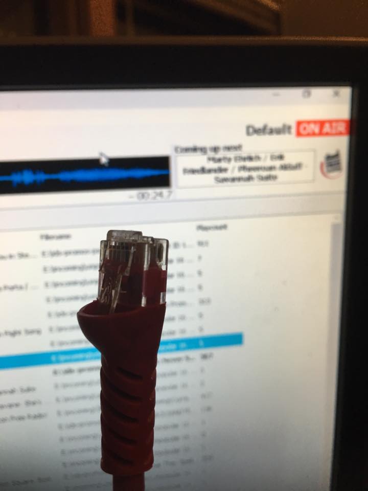

It also will say "active" and "ON AIR" even if we disconnect the network cable from the PC.
Is there an error message like "Server connection closed" in the log? I don't see any in the screenshot posted.
It could be that your server is set up incorrectly. I'd suggest you to try the trial server at http://www.radioboss.fm - just test if it works fine or not.
Sometimes streaming problems are introduced by antivirus software - if you're using one, try disabling it.
The ON AIR merely indicates that broadcasting is turned on, it doesn't indicate the actual connection state.
[2016-01-29  15:21:34] WARN source/get_next_buffer Disconnecting source due to socket timeout
From this line, it appears that Icecast  disconnects you because no audio stream is being sent. In your settings I noticed that you use Input 1 as sound source. Try changin it to Audio Mix - in this case it will broadcast everything that you play in RadioBOSS, while Input 1 option is used to use sound card's input as broadcasting source.

3) Input 1 is our soundcard's input, which is the output from our broadcast mixer. For troubleshooting, I can test with just the audio mix-- but this doesn't help us long-term.
If the input is set up incorrectly, then RadioBOSS will not send any data to the server, it also won't be able to detect that the connection was closed by the server for inactivity (this is how network protocols work, if there's no activity, then there's no way of telling that the connection is actually still alive).
