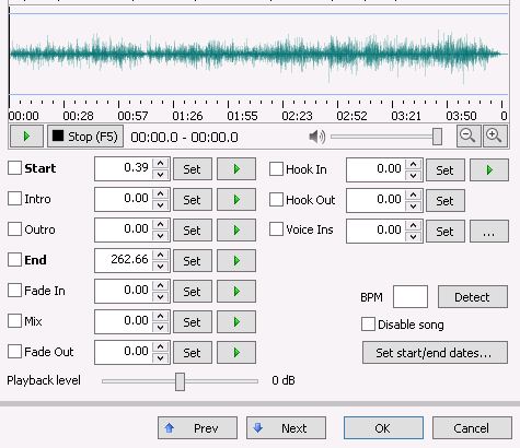

I am really enjoying RadioBOSS so far and am using it for a 70s station. There is one thing that I have been unable to achieve in understanding with radioBOSS and with getting the setting right.
How can I set the music to NOT overlap with the next song until a set moment in the file? The song that comes to mind is Led Zeppelin - Stairway To Heaven. The next song always overlaps and cuts off the end of it. I know the volume is soft at that point, but in other software that I have used I was able to set the "cue" time to the very end and it worked brilliantly.
I go to track tool in RadioBOSS and don't see a cue point to set. I have attached an image of the track tool that I was going to work on.
So... are the good instructions on where to set the cue point for the next song so there is no overlap?
Any help would be greatly appreciated
You can do it in RadioBOSS too, this is called "Mix" - you can do it in the Track Tool. Just set the mix point where you want the next track to start.
