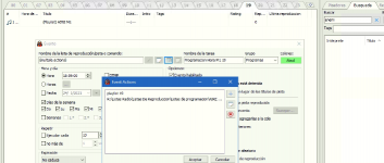

You can use the multi-action event to load all playlists to all of the tabs (set active tab, load playlist), and add one last action to change the active playlist tab to the first tab.
The problem with this approach is that using multiple action events will not insert the content of the playlist.
I guess I should create two events for this. true?
Yes, if you also need to open up the playlist, it will be two events. The downside is that it will also start playback. By the waty what is the purpose of using a separate tab for each hour? Why not load the next hour playlist with the "Clear playlist" option and simply use the single tab?
This is how I am working now.
The advantage is that I can manually edit the tracks every hour.
At the beginning of the day I load the 24 playlists in the windows and I can easily edit them. (No need to load the playlist manually)

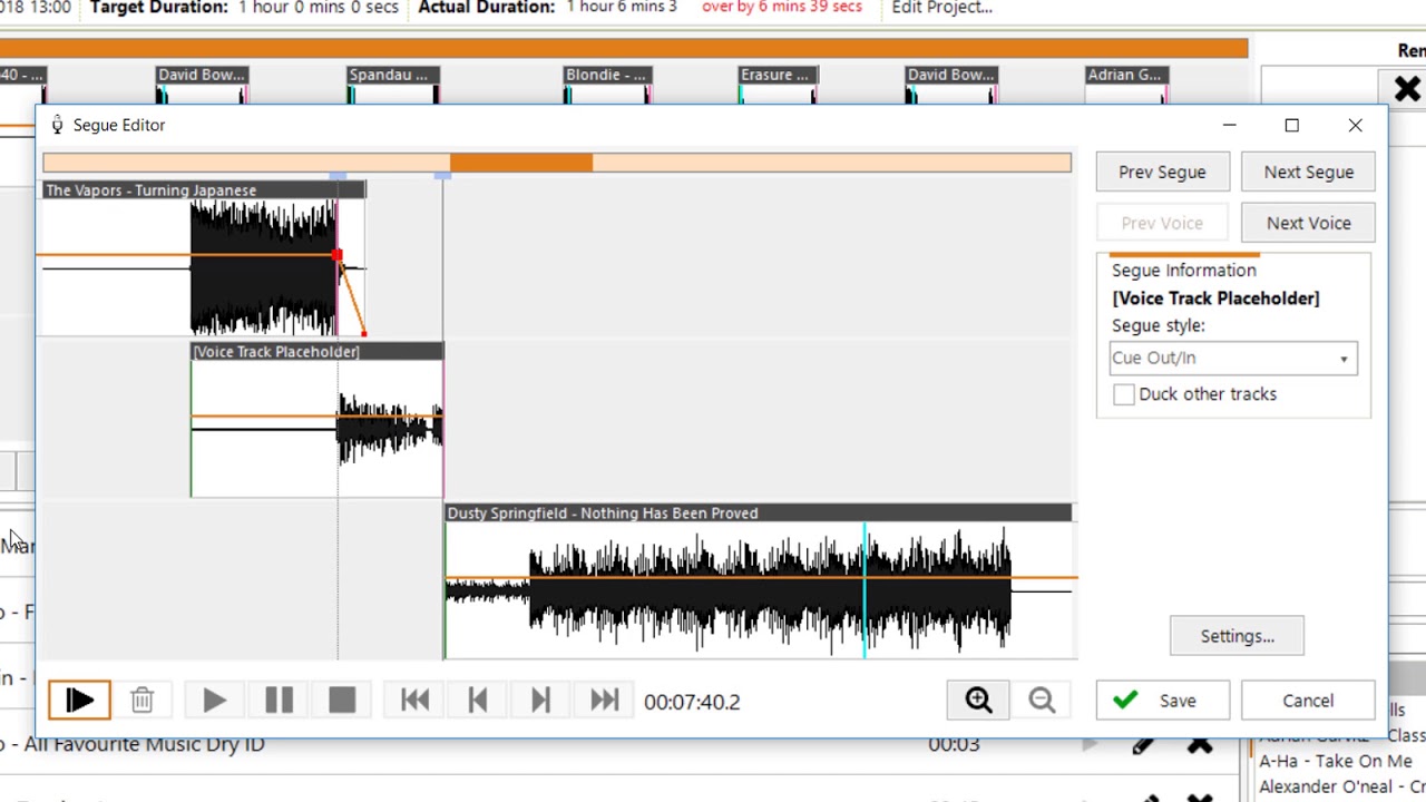

The idea is to lower your voice when the announcer starts speaking and then raise it when the voicetrack ends. Basically it is to replicate the behavior of voicetrack in follow editor.
Here everything is automatic, from the place where you are positioned, when you start recording, the program performs an attenuation of the track that ends (through the voicetrack).
when next is pressed in the recording the track starts but also at a low volume since it is riding on the voicetrack. Then at the end of the voicetrack it should be returned to the original volume.
All this is done through points that the program creates, which are editable with a simple click. It is something very similar to adobe audition (multitrack mode)

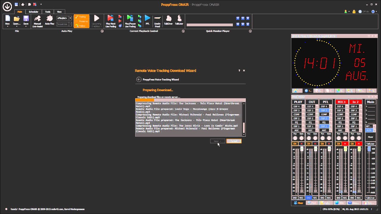

A look at another remote voicetrack implementation (ProppFrexx)
https://www.youtube.com/watch?v=8A7rNHUasb0
There are very interesting things here. The program downloads the playlist in low quality, that is, it converts the tracks to another format for a higher download speed.
Then the announcer records the voice tracks with a kind of "follow editor 3" with recorder. (I think that was always the reason for a follow editor 3). Finally the changes and the new voice tracks are uploaded.
As in the other software that I mentioned earlier, when pressing "rec" the cue playback starts and a next button is enabled to launch the next track.

Converting the tracks is a lenghly operation, then downloading (this will also require a static IP which very few have or use an external service), I'm not sure this is very practical.
I think that in this type of services a public IP is essential. For example to upload new voicetracks.
It is true that it takes about 3 seconds to convert the tracks, but then the download speed is much higher.
Imagine a flac converted to aac 32kbps.
This program, before starting the recording, performs the conversion and downloads so that later everything is transparent.
In addition, any change in the playlist is reflected in the remote administration. Eg if a new local track is added, this is sent to the server. In the case of remote tracks this is not necessary to go up again.
I have noticed that Proppex did not invent anything new here. The most expensive software in the industry works the same way. To name a few Zetta, Myriad, PlayoutOne.
What we have here as segue editor 3, actually in other software it was thought for voicetracks.
All these softwares work in the same way. extreain the first 10 seconds and the last 10 of a song. They send them in low quality so that the announcer can talk about them.
When rec is pressed, the preview starts. Then the announcer can speak according to the tone of the subject, at the necessary moment. "The voice is in a tone according to the background music" With this it is possible to create a "live effect".
A local implementation of this would be a good start for now
