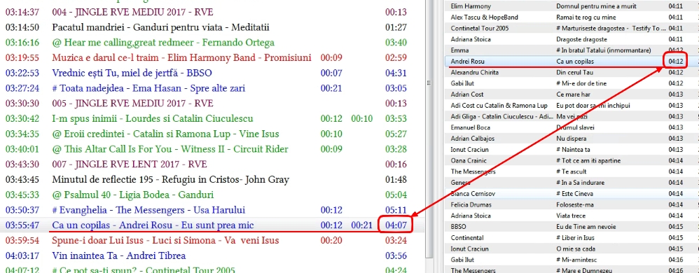

Playlist and Search do not mach
Duration of the Track(s) in Playlist do no match with Search.
Very annoying ! Need help !

Because this information is now always loaded. A quick test shows that duration in the playlist and in the search match. It can be different in the playlist if you have used a segue editor. Maybe there are other reasons also. Both Search and Playlist load track information and display track duration considering the Start/End points set in the track.
I use 5.9.4.0 And it is horrible to make playlists. Time in search do not match eith time in playlist. Please do sometyhing about it.
It's some other reason then e.g you edited a track and info in search or playlist is not updated yet. Search in RadioBOSS 6 now always loads the track information (and does it much faster than 5.9).
You can still use them in Playlist Generator and import them to a new library format. The next 6.0 beta update will also allow creating .xml libraryes with makelibrary command for backwards compatibility.
