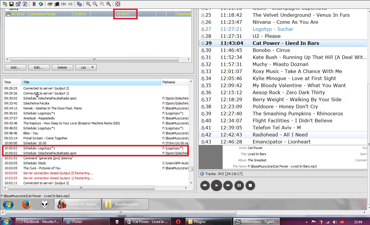

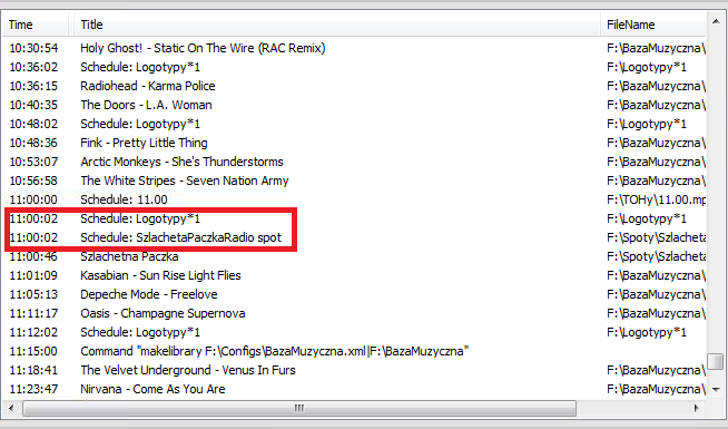

I noticed the incorrect "next run" time in scheduler.
Can you please give more information on this - what was the time at the moment and why do you think that start time is incorrect? If it's about ":02" second (while it should be :01) then it's due to number rounding while calculations...
I took the screenshot at about 10 a.m. I know that its start time is incorrect since i want this particular task to start after a TOH @ :00 but before an event "Logotyp" which begins @ :02. See attached screen(s) that "Szlachetna Paczka" runs after a "Logotyp". I don't get what rounding are you talking about since we're adding an integer (30 mins in my case) after each repeat  ???
Internally those numbers are not integers, therefore rounding. You can try starting "Logotyp" event @:03 to overcome this problem.

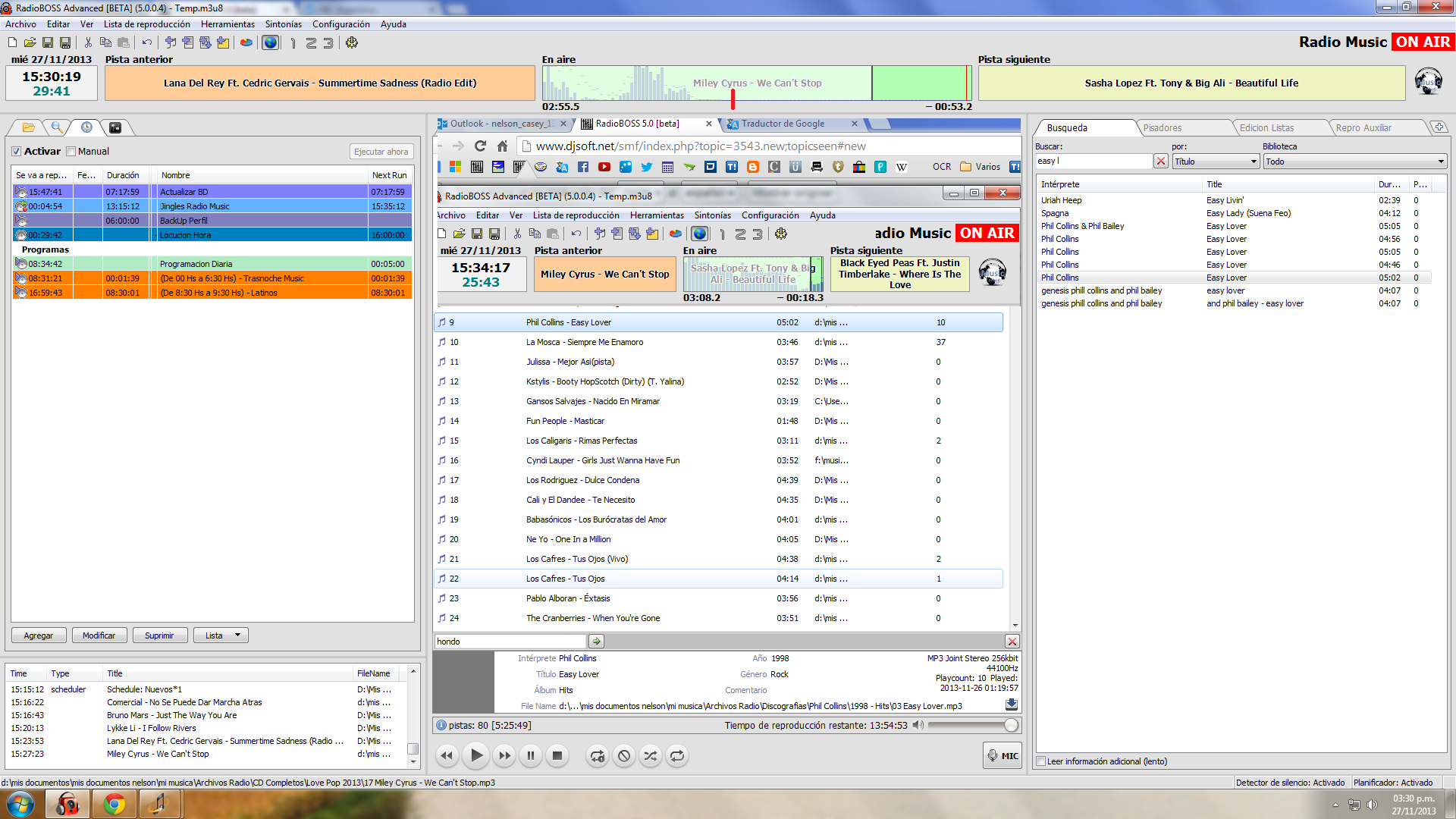

I also realized that there is a problem with the resolution of a netbook in the left pane:
It is impossible to see the log (and therefore change its size), and inclusive event buttons (now run, edit) is cut.
Please send a screenshot of the problem.

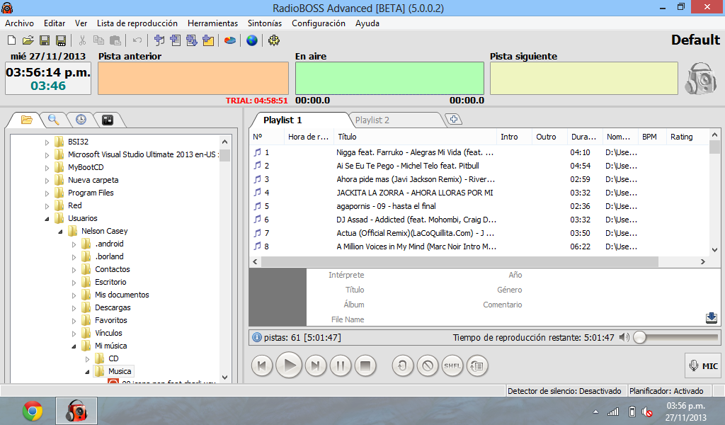

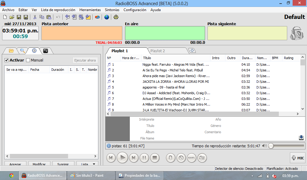

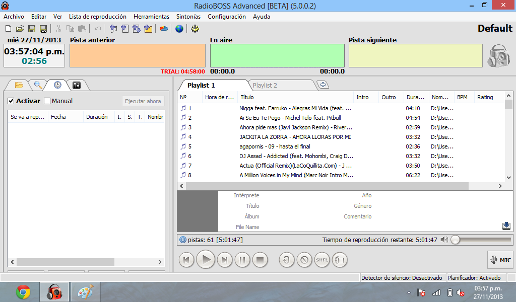

Errors in current track number:
-The above mentioned error occurs using the api command "Move", if this command causes the position of the track to move the air, this causes the number of the current track is misinformed.
-when RadioBOSS, another tab is not active this command is reported.
Once RadioBOSS also tried on a monitor 32 "and it worked well too.
this error is strange, it happened a while ago and I could fix by changing the profile.
but now appeared again (when changing a sound card) and now will not leave.
Even try to reuse the other plate and this continues.
atached screenshot.
also there was an error changing the size of the program.
attached report

atached screenshot of my netbook

atached screenshot.
That's something odd at the screenshot. Somtimes things like this happen when you have Web browser tabs. Try removing them and see if this continues to happen.
It has very low vertical resolution (600), that's why RB's window can't fit there... I'm not sure if this can be fixed.
If I agree that the resolution is very bad, but it is common in all netbook.
I just found an "alternative" to solve the problem:
Hiding the taskbar, could "shrink the size of the log", save the profile and then put the taskbar back.

RadioBOSS turns off after _several_ days of non-stop usage (dunno exact period) saying that the trial has ended. Is this normal? We're using the 5.0.0.4 beta with the beta key.
I have discovered as causing the problem from the api, which cause to be displayed in the list are two tracks playing simultaneously.
Steps to reproduce the problem:
1 - Queque Mode enabled (not sure if this influences)
2 - Using the command "Move" API: move the air track down and and NEXT to the position of the one in the air.
3 - Press the Api command "Play" + the number of the track that moved (which was before the track below the air but now this before.).
  For example:
Number of Track-air (on the list): 2
From the api:
- Move "Position 3" "Position 2" (Now the air track will be in third place in the list)
- "Play 2"
Track error in RadioBOSS air occurs (see screenshot).
