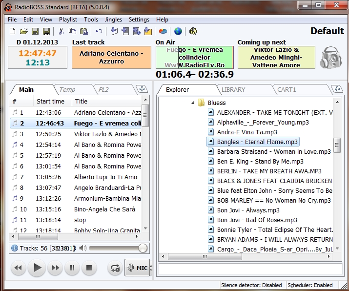

Double click doesn't add track in Main Playlist
Double click works for "Search" Tab in WZ.

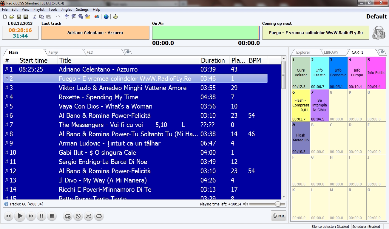

Playlist -> Extra -> Calculate playlist length
Doesn't work right. User can't see the result.
See in file. Why is that in cells ?
It used to add in the past but this was turned off... I don't remember the reason. I should check the development logs. Probably this will be turned back on.
This just re-reads tracks durations in the playlist. The results are visible at the bottom: total playlist duration, playing time left.

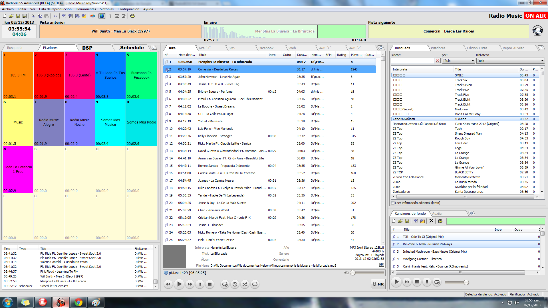

I would like to remove Control Panel from left side of RB. For that I need Scheduler and FX in Work Zone 2. Can you do that? For us Main Playlist Panel and Work Zone make sense.
@pety-You want to remove the left panel?
Now you can: :D

Thanks, I knew about [Ctrl-L].
My point is WZ with Scheduler, Cartwall, Explorer, Search (Library), FX to have only two panels. If I work with SCheduler then will be three panels...

I had thought something about it. just not what I wrote here to not be overwhelming  ;D.
With new areas of work left panel in my case it is used less often (and I see yours too).
I would like to turn it into a working mode to couple auxliares players and effects panels.
Maybe have two panels Schedule or DSP, Serious confusing for the user, but maybe this leave can be activated only for this area of ??work (which is now in left panel)
Thus one could better use the screen space and have everything easily accessible.

@ nelson c
Understand what you say.
If GUI is configurable there will be not any problems.
Someone will  keep all three panels, someothers only one and me only two.
If in WZ will be added Scheduler and FX I'll be the happiest RB user.
I am not saying to phisically REMOVE left panel. For that I will use [Ctrl-L]. What I am asking is to have in WZ: Scheduler and FX. That's all.

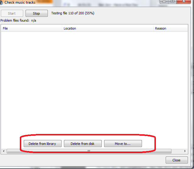

Just done a full "check music tracks" in my library and it has found some corrupt tracks. When i try and delete the tracks, I am unable to do so as "they are open in the music library"  ???
Yes, this is planned for one of the next versions. Actually, this is already implemented but requires a lot of testing before we can publish it.
Interesting idea. The left panel can be unified with Work Zones, so anything can be added anywhere. Theere are several problems here (like a user can add several Scheduler tabs in different windows), but I think we can handle it somehow. In 5.1 or 5.2 this will be done :)
Well, this will happen pretty soon. In 2014 for sure :)
Thanks  for reporting this, looks like a bug in the Music Library.
