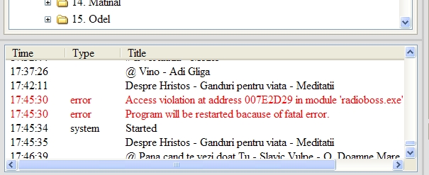

I have discovered as causing the problem from the api, which cause to be displayed in the list are two tracks playing simultaneously.
Thank you, this will be fixed in the next update.

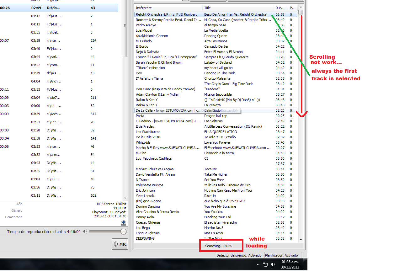

While charging the search list, you can not do scrolling, RB always selects the first track and you can not lose the list. (See screenshot)

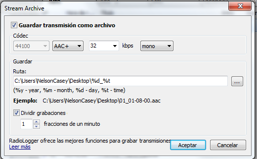

The logger included in RB recording absolutely nothing.
Are you sure? Please post a screenshot of its settings. Probably it's some sort of misconfiguration.
That's strange - I've just tried to reproduce this, but it works as it should...

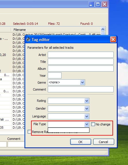

In RB 4.9.1.0 is tag editor but "File Type" assign for multiple files doesn't work.
Can you fix this ?
Attachment capture. the desktop folder no file is created
This error only occurs when loading the database, for example:
Seaching .. 39%
I think we'll record a video, I saw this error on two of my pc

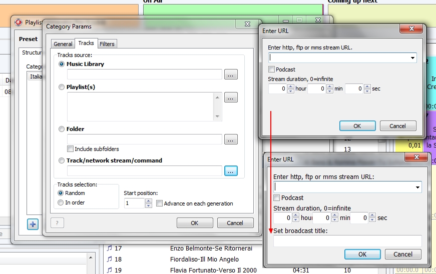

Playlist Generator Pro - Add URL Stream.
URL window looks incomplete.
I would like to be like in "Playlist -> Add URL..."
See image
Broadcasting titles currently not supported in Playlist Generator Pro. This will be changed in the future updates.
OK, this will be tested.
Seaching .. 39%
Yes, while list is populated you can't do scrolling. You should wait until it's completed or click Stop.
