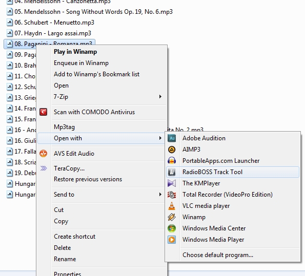

I would like to access directly TAG EDITOR.
How can I do that, becouse I want to do it :)
What do you mean access to tag editor? I'm afraid I didn't understand...
For example, I can use directly from Windows explorer "Track tool".
I would like to do the same for RB Tag Editor.

RadioBOSS Tag Editor is very helpfull as separate tool for production. Very, very, very helpfull.
Of course, I need to install RB on computers from production area with the same settings ("File Types") as in RB Live to be possible to select File Types in Tag Editor when I select a lot af tracks to edit tags.

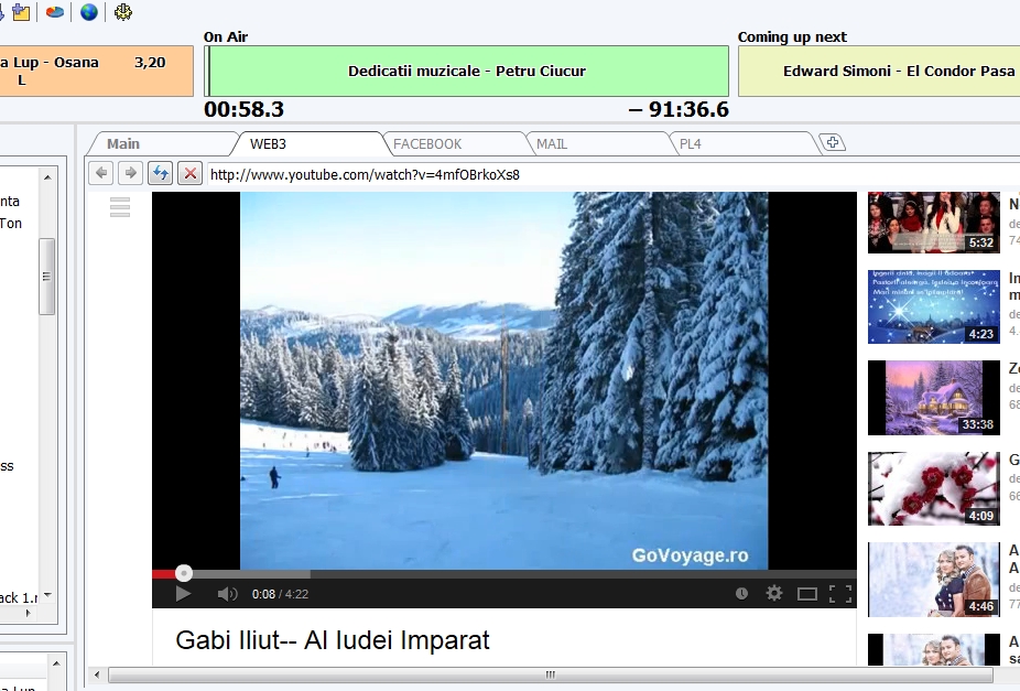

I think there is a bug in RB Web playlist.
youtube movie starts when RB is openning.
DMITRY, I WOULD LIKE YOUR SOLUTION FOR TAG EDITOR.
IF YOU CAN'T DO IT (FOR SOME REASON) I WANT TO TELL YOU THAT I SOLVED THE PROBLEM WITH MP3TAG.
I CAN NOW USE MP3TAG (http://www.mp3tag.de/en/) FOR ASSIGN RADIOBOSS "FILE TYPE" IDENTIFIER TO THOUSAND OF TRACKS WITH ONLY ONE CLICK  ;)
RB remembers the last URL visited, and if it was YouTube video, then it will play when you start RB.
I guess you've already found the solution :) I split your post to the separate topic: http://www.djsoft.net/smf/index.php/topic,3578.0.html
Maybe in the future an utility you request will be released, if there's demand for this from other users.

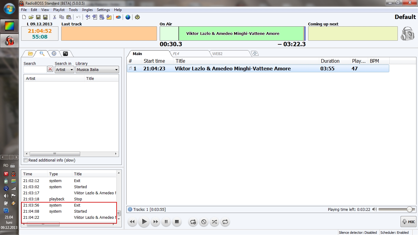

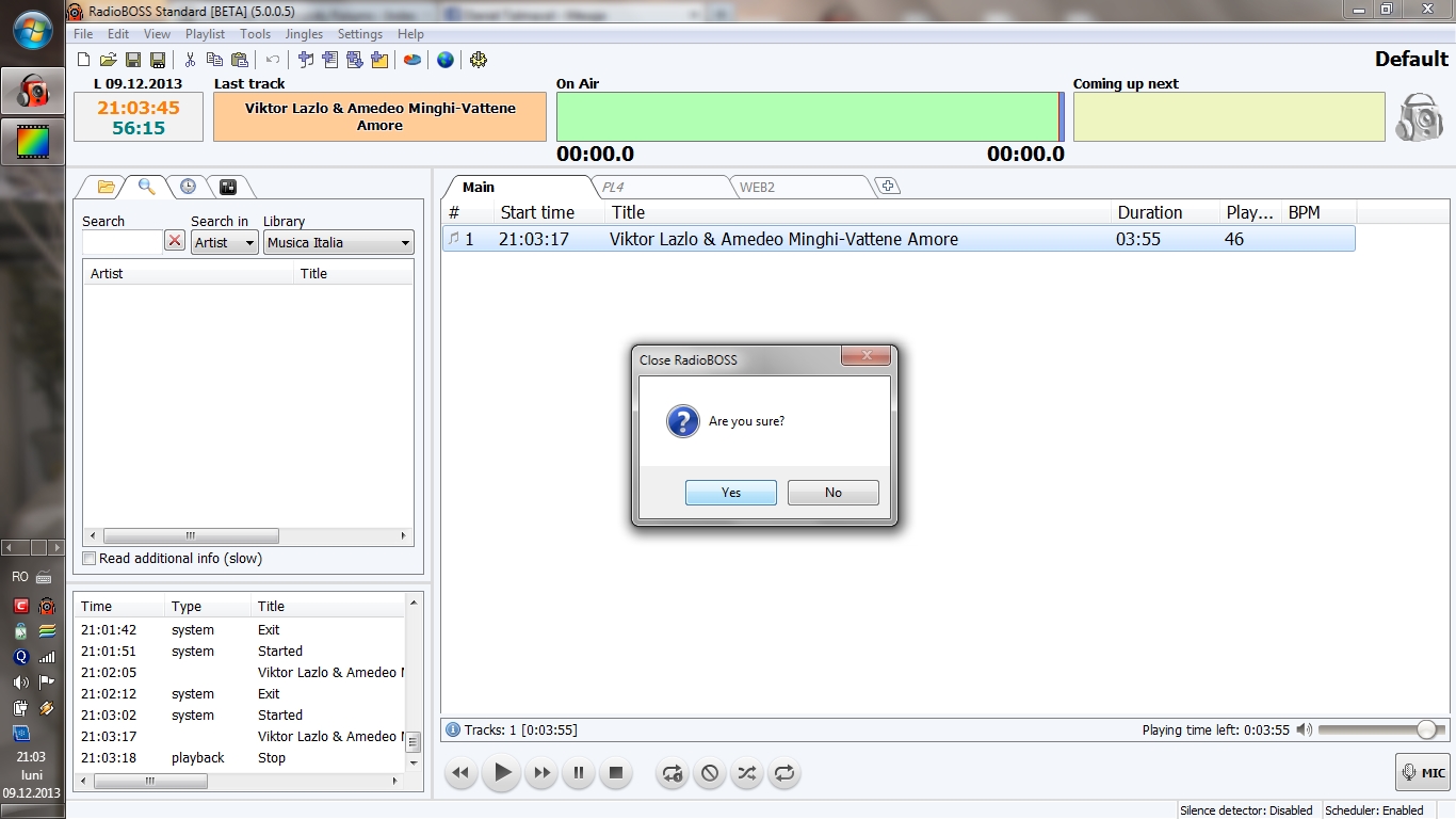

There is a bug.
1. I started a track, then I stopped it. Close RB.
2 Open RB and it resumed stoped track.
It shoud remain stoped isn't it?

There is a bug.
Sorry, I attached big pictures.
Yes, it's a bug, will be fixed in the next update.

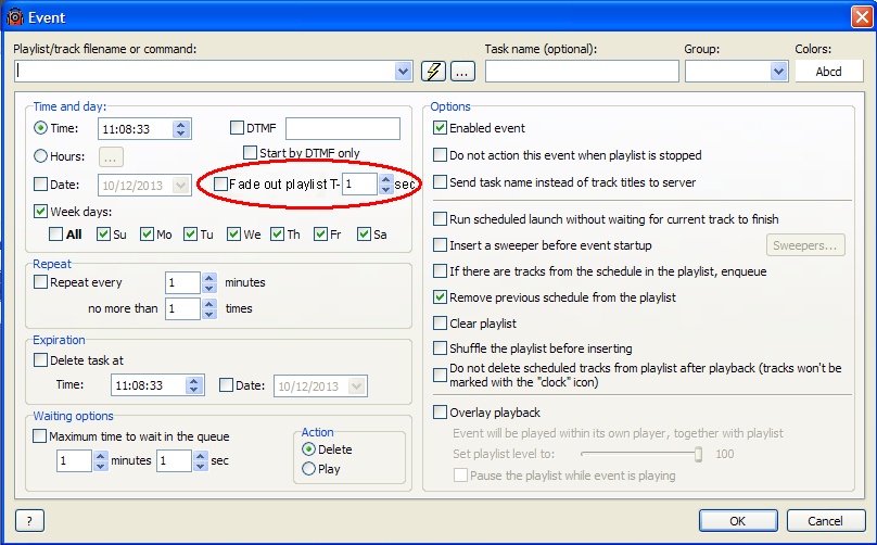

Hi Dmitry
Is it possible to add the playlist automatically fade out, when playing the scheduler event and customize the time.
I know you can do it using the event "fadeout" before, but why two when one can do it automatically.
example as attached
example as attached
When event starts to play, it will fade out the current track already (according to crossfade settings).

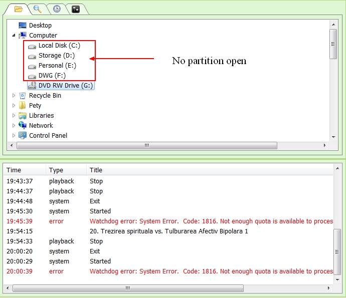

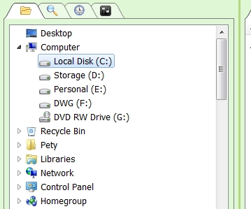

Watchdog error: System Error. Code: 1816. Not enough quota is available to process this command
Explorer doesn't work...
Prelisten from Control Panel -> Explorer and WZ doesn't work. It is loaded but faster dissapear...
