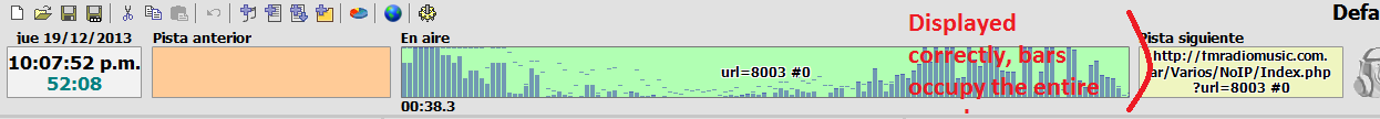

It is a problem of interface (audio bars).
In any moment of any song a bar that exceeds 35% of the audio bars (red line) is shown.
I mean the problem is that the bars do not occupy the full audio panel air.
The strange thing is that in my notebook when I enlarge the panel everything works fine. (Screenshot of my notebook)
as I posted previously reinstall windows and the problem persists

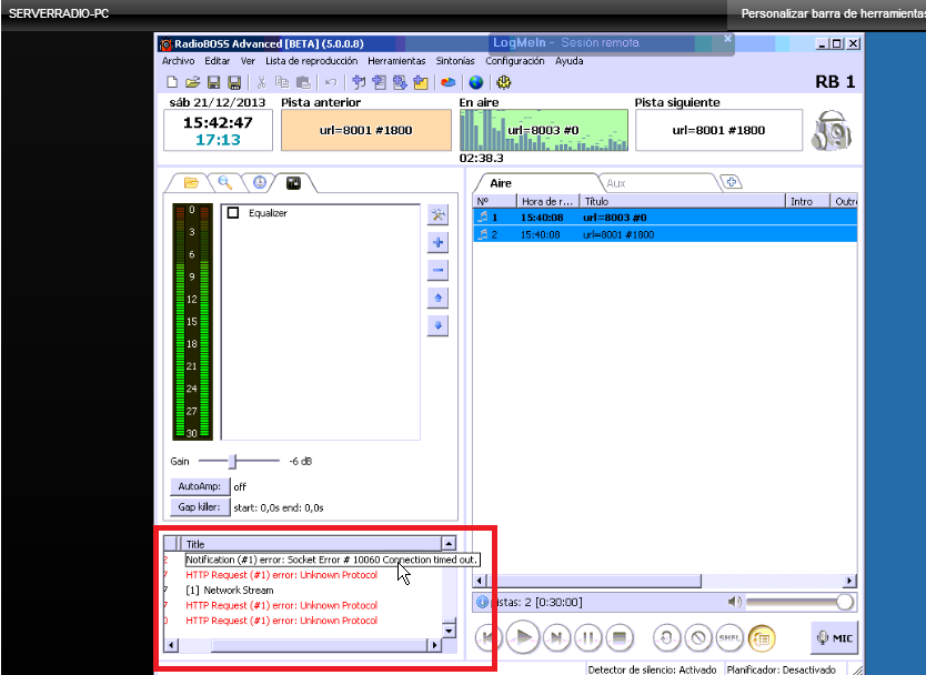

With a PC I am having trouble sending email notifications, I have several Windows services disabled is perhaps why.
I appreciate any detail.
Do the same settings work on another PC?
exact

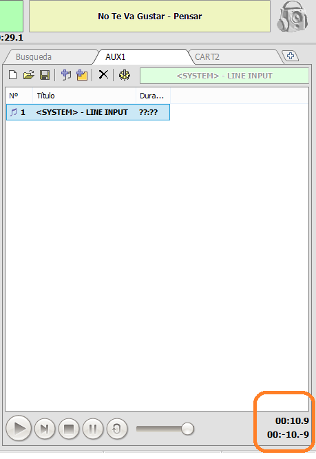

There is a problem with the countdown in the auxiliary players.
(when used in line-but I guess streaming too)

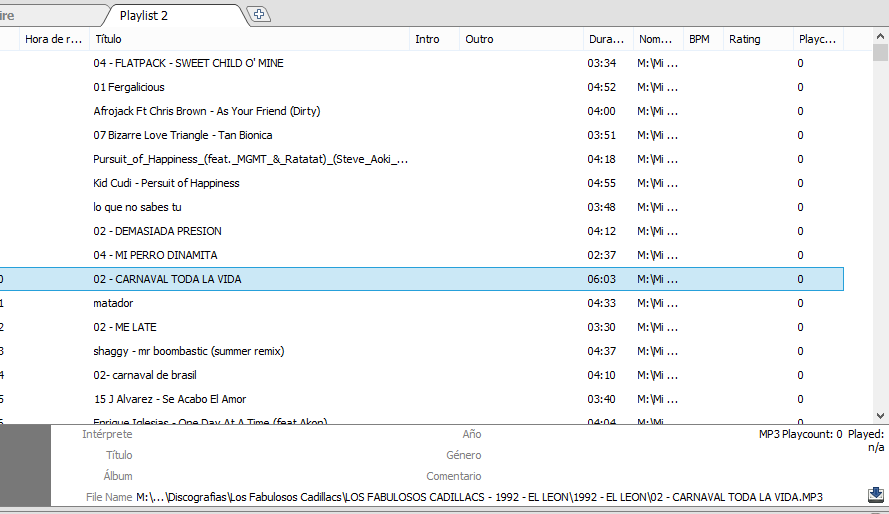

Petition:
You can add an option to not read tracks and metadata based on those included in the playlist and when I add tracks from an xml read metadata from a database to load the metadata in the playlist ?.
I am using Google Drive to synchronize and xml playlist.
then add songs from the notebook in playlists (eventhough I did not file this physically here, I rely on the xml generated in the production pc)
the problem is that when I save a list lose the metadata in the list, since radioboss reads the metadata lists when charging.
The result is that the lists are like the picture I attached
exact
Well, if the same settings work on another PC, then the problem is not in RadioBOSS. According to the error code (Network time out) - it was unable to connect to SMTP server.
Thanks for reporting this!
Yes, in one of the next updates RadioBOSS will use XML playlists and will store/read all information from there, instead of reading it from tracks.
exact
at all the problem is not in RB, you may need to open ports on a router?
