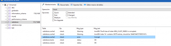

I have a problem with MariaDB.
The service closes immediately when you start using it. Also when trying to generate a backup from HeidiSQL. I did an analysis and found the following
It appears that the database is corrupted. If you have a backup, I'd suggest to delete this database and restore from the backup.
