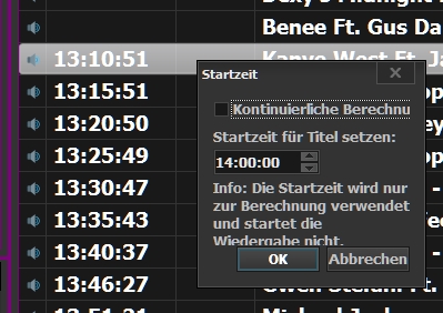

Calculating the starttime in the active playlist always shows the actual time
If a track is playing it will show the calculated start time from the playing track. The custom start times are intended to be used in secondary playlists.
It was much better in the 5.9 for planning a broadcast in an active playlist
The option continuous Calculating is as good as useless now
Please make it as in 5.9 again iff possible
If a track is playing, it will show the actual start time. If nothing is playing, it should work as it was in 5.9 - it seems like a bug if it doesn't :)
