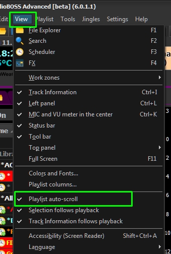

Good evening from Greece. We are having a problem with the program. I have a vision problem to tell you and I use a screen reader. The problem So there is within the two available playlists. When there are songs, press the enter key and it goes to the wrong song. Let me give you an example. If you click on the song One the enter key then automatically throws you to the last song or in the middle of the playlist is not fixed so you can normally see the songs you have in the playlist. The problem is very serious please Correct.
Maybe scroll playlist is checked in your settings

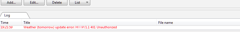

is there any way to "switch off" the log window, i have it really minimized down in the bottom left of the screen, but it keeps "popping up" just a little everytime there an entry, mainly an error from a weather api, its not a major issue, its just i have to frequently drag the bar down to hide it
Currently not, by design this part must always be visible - it shows any errors so that you can see if something goes wrong (RadioBOSS uses very few popup error boxes) and also Overlay events are also disaplyed there.

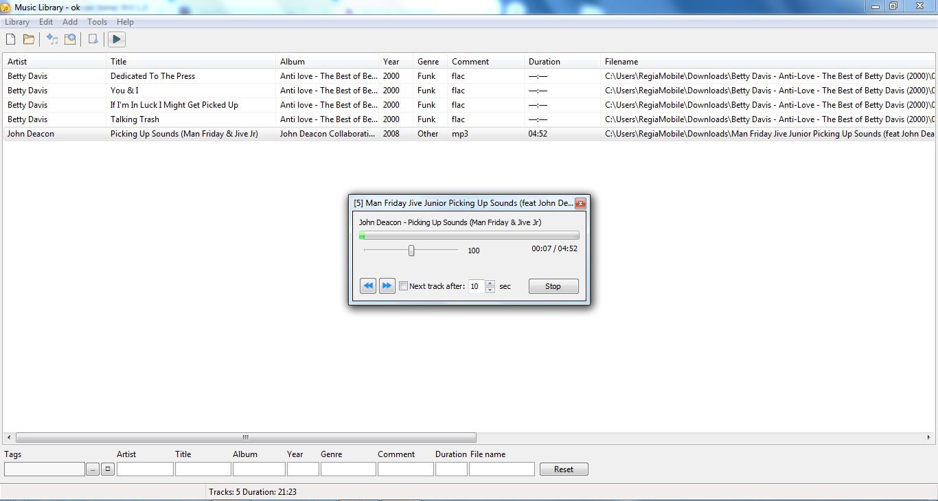

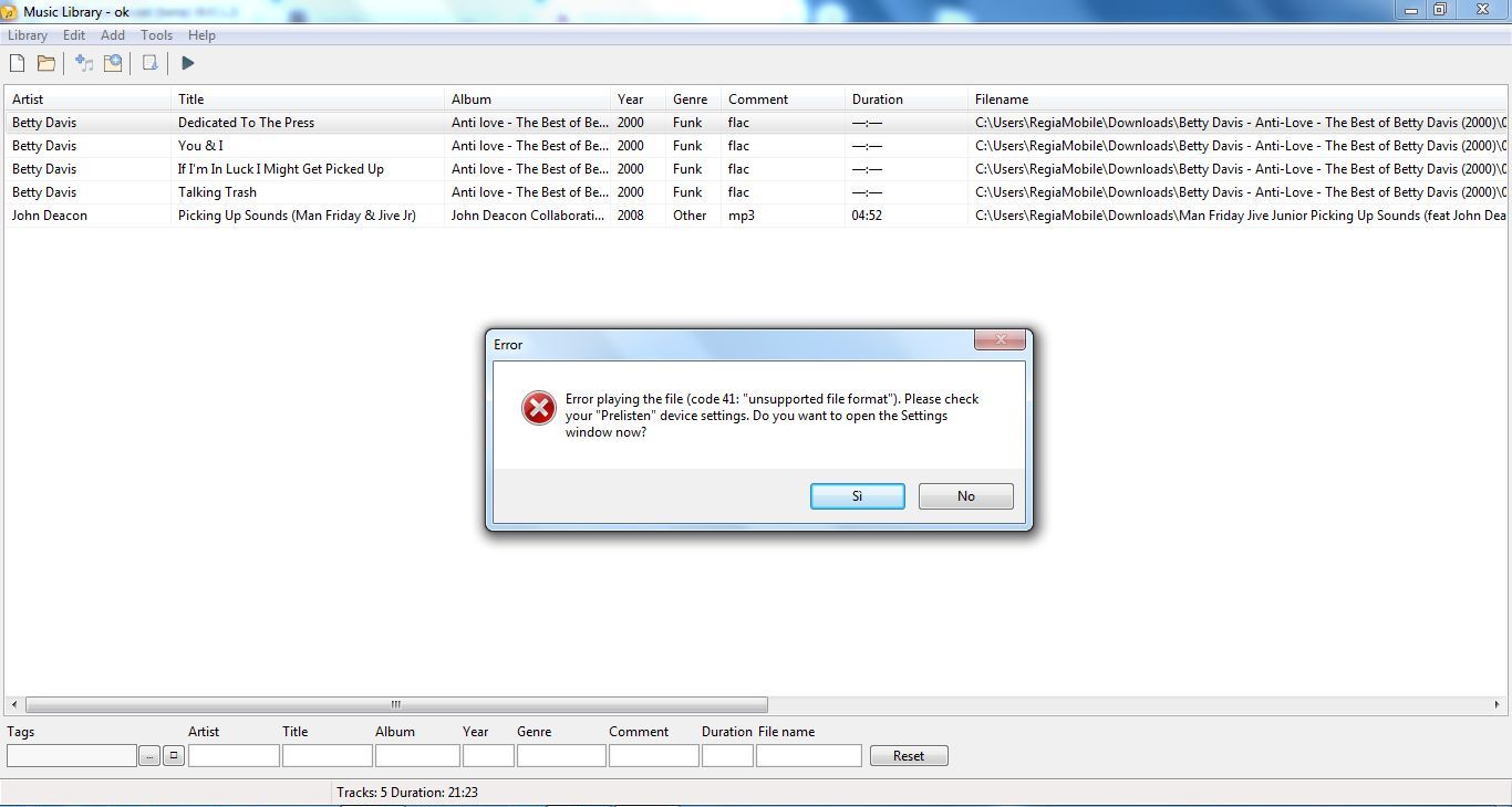

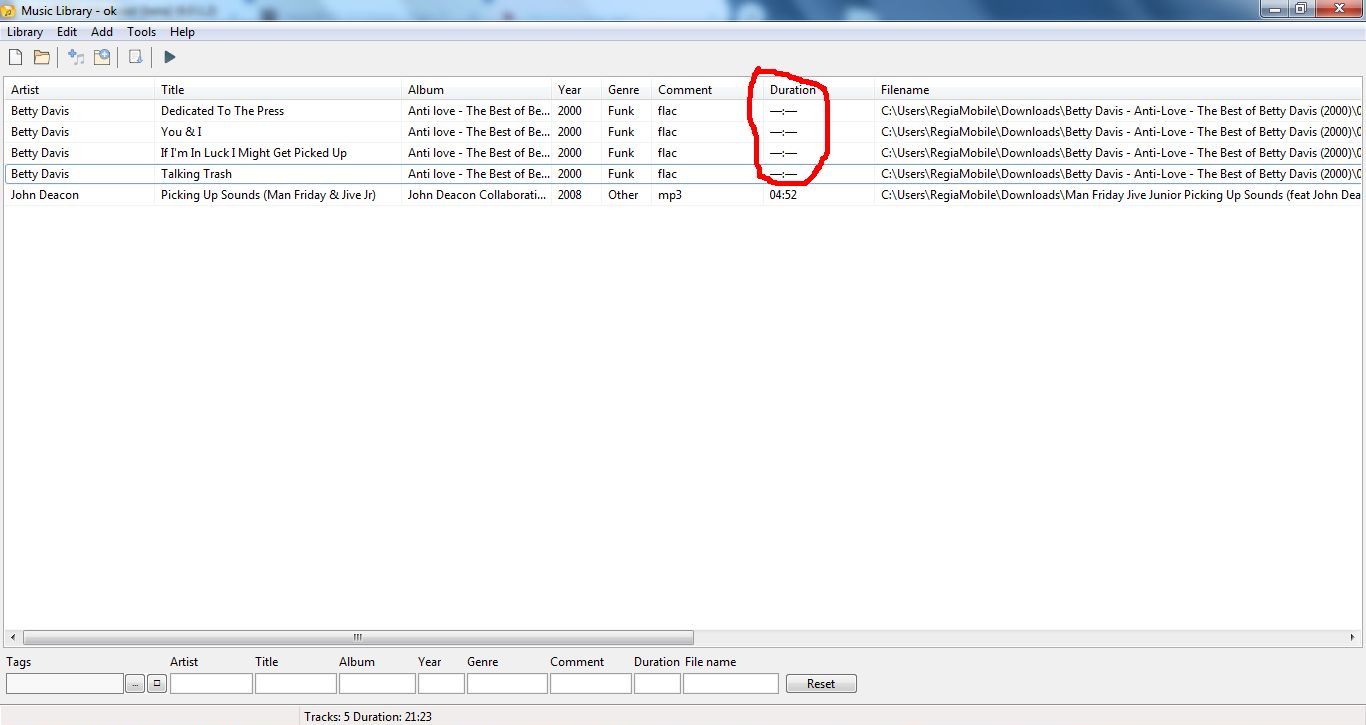

Hello, there are problems with the music library with flac format files.
1) Duration of the track.
2) Flac file format not supported in preview, ok mp3 format file as in photo 3.
Thanks
FLAC works here. Are you sure the file is actually FLAC and not something else with ".flac" extension? Please send us one of such files to support@djsoft.net, we'll see why it's not processed correctly.
Beta tester keys are no longer issued for this version, I'm sorry.
flac files put in the playlist on air work.
the preview in the music library player does not work.
