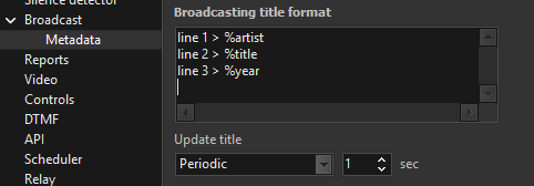

It's not about the weather, it's about any line being unselectable. Let me explain this with a different example. Let's assume we filled the meta data field as shown in the picture. "nowplaying.txt" is not clear which line it will be, it is written randomly. Since the lines in this area constantly change according to the duration, the piece writes whichever line is on the line at that moment during the change.
This text can be "line 1 > %artist", "line 3 > %year" it chooses this completely by chance. That's why I suggested there should be a separate privatization.
The selection (for streaming title, as in your screenshot) is not random, it uses them in order, 1->2->3->1->...
On each title update, it will use the next line from the list.
I know that it moves through the lines sequentially, but it is set with a time limit, it is not set to move as long as the piece changes. When you set it for 2 seconds, it travels continuously. If it comes across any moment during the track change, it writes it to the "nowplaying.txt" file. Because of this uncertainty, I stated that it was random. I can explain this better if I show a video example.
