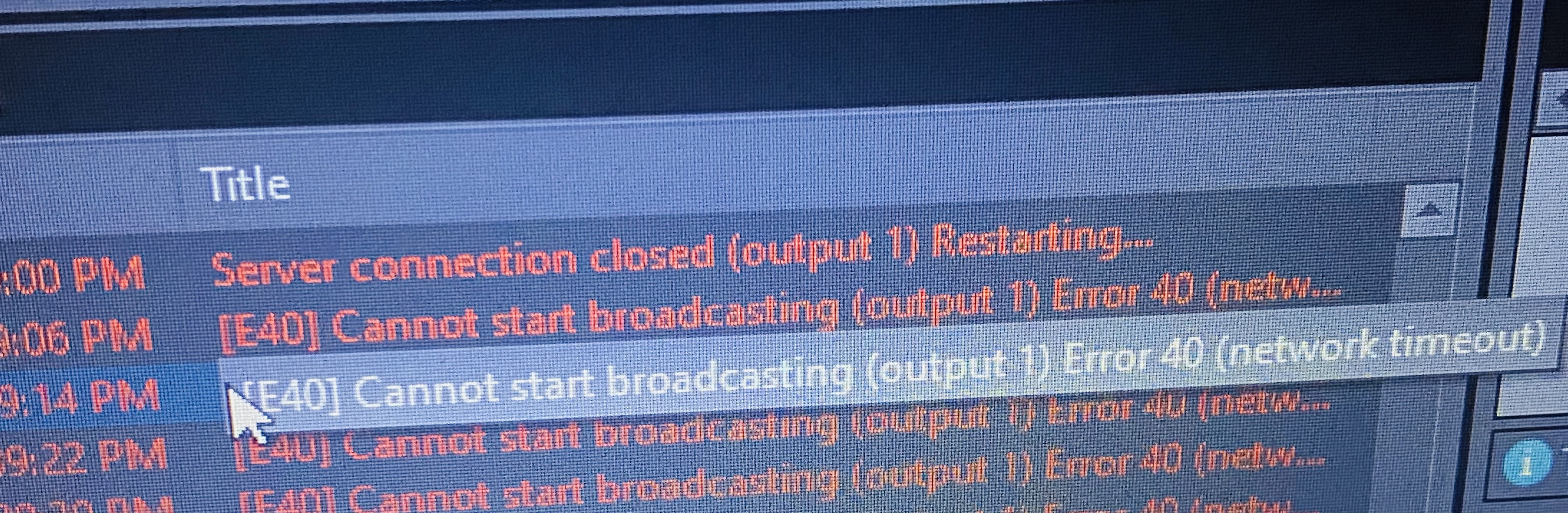

& The Below! Both errors appear and disconnects stream time to time!

There's "Error 40" message which means it can't connect to the server - the connection times our, or it connects but can't read/write any data. Please ensure that the server connection is configured properly, and also that the server is in working state.
Thank you I’ll check the server again & what’s the error 46 Device is busy?
