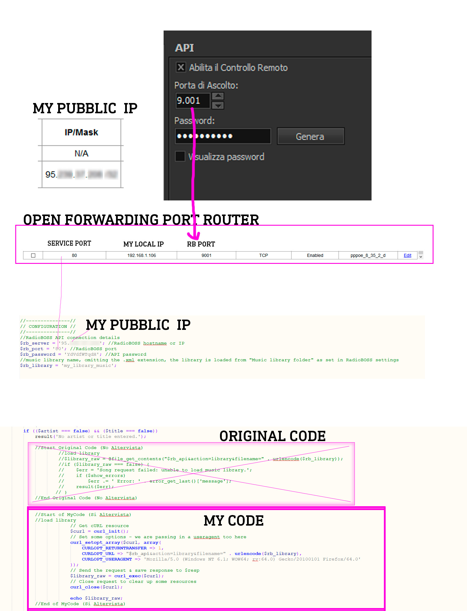

in practice I had to:
1. create a Forewarding rule in the router by setting the service port (i.e. 80), local IP (the PC IP) and local port (the one in RB)
2. the php script:
in $ RB_Server put the public IP assigned to my router
in $ RB_Server put service port (80)
3. the php script provided on the site works, but in my case I had to modify it, because I had problems with my altervista.com server because it does not accept the "file_get_contents" statement so I modified the php by changing it with cURL.
Now it works with all web hosting.
Except those that do not support cURL :) It is a good addition, and we'll add the cURL option (configurable) to the demo script as well.
