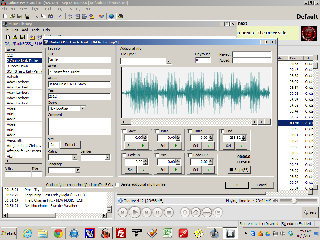

Can you add an option where when gap killer is enabled, it will automatically check off the "start time" and "end time" box in Track Properties for each song in the music library? It automatically adds the times, but doesn't check off the boxes.
Yes, it's done on purpose - you should manually check the boxes if you want to use the calculated values. I think a setting can be added to control this behavior.
If gap killer is enabled it will cut the silence automatically - you don't need to set Start/End points if the values are the ones detected by Gap Killer.
Yes. I understand that. However, the GapKiller doesn't change the length of the song unless the box is checked off. For example, you have a song that is 3 minutes and 5 seconds long. The 5 seconds of the song is silence and the GapKiller cuts it out. The song in the playlist still shows up as 3:05 instead of 3:00. When the song gets to 3:00, it skips the 5 seconds and moves to the next track. This can through off the start times of the other tracks in your playlist.
