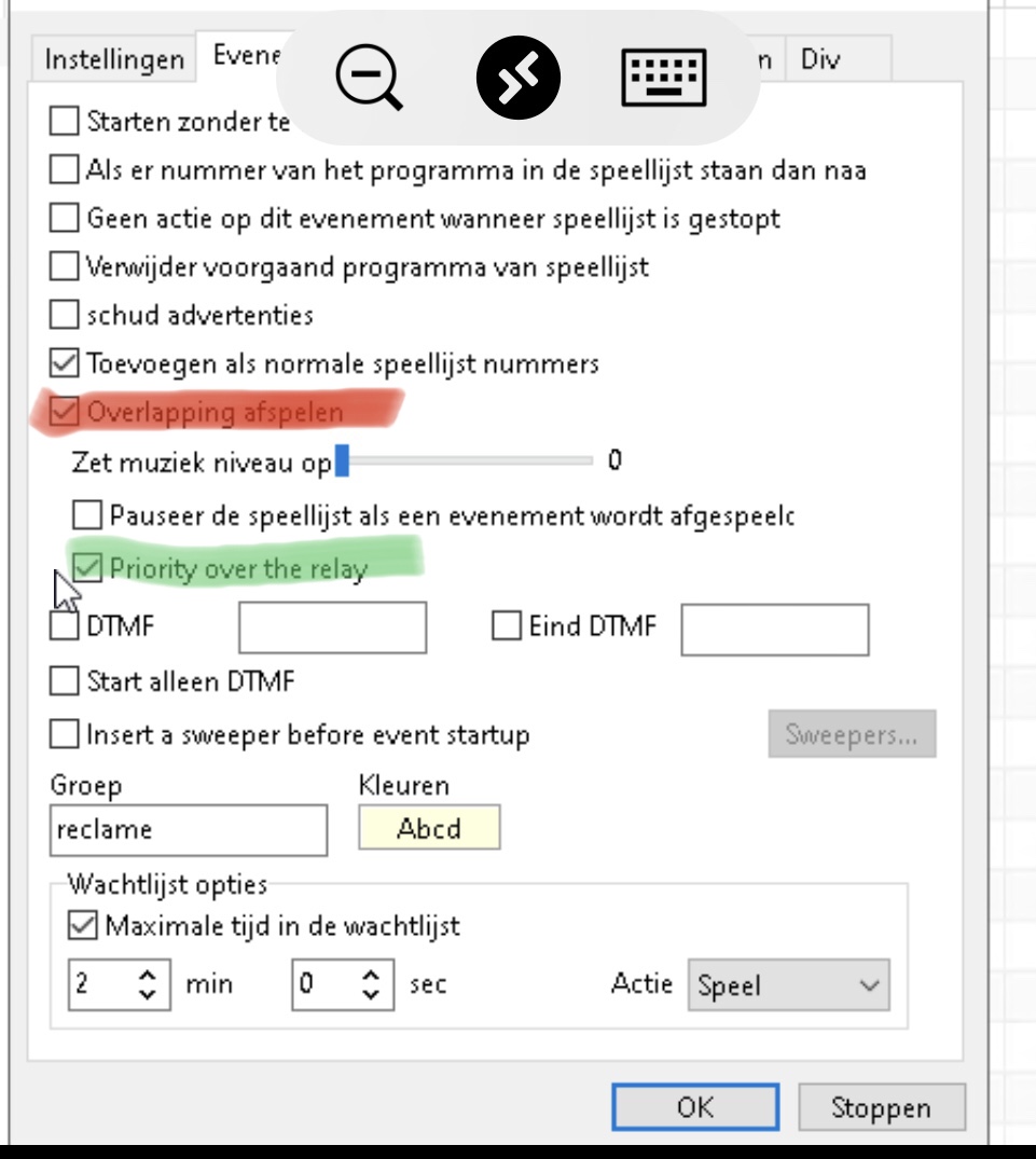

My radio advertisement starts every hour at 00:54, and it varies when it ends.
After the radio advertisement, I want a new track to start and not a partial one.
I can achieve that by disabling the overlay.
However!
If I disable the overlay, the advertisement doesn't play over the relay stream because it is inserted as a track.
If you use relay, it means you rebroadcast some other stream, therefore you don't have control over what plays there, and can't start next track in the relayed stream.
Red out
Green on
I understood the next number. overlay off. Only when we use a live stream do I want it to go over the live stream. so the DJ doesn't have to do it manually. Then a new number doesn't work, I understand that.
