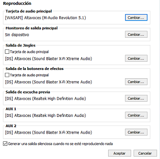

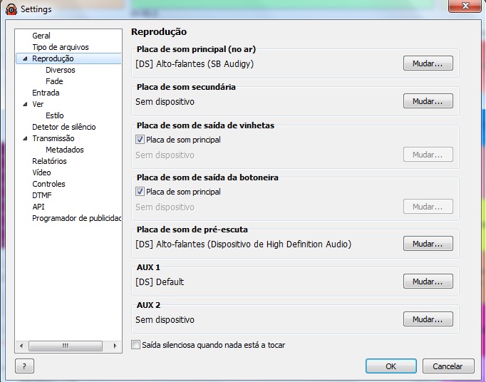

Please send a screenshot of Playback configuration in settings, we'll try the same setup as yours here, because the bug does not reproduce here... It reproduces only if "Default" device is used, though, but not when specific device is selected.
Error 37 means that playback can't be started because device was not initialized properly.

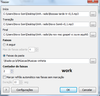

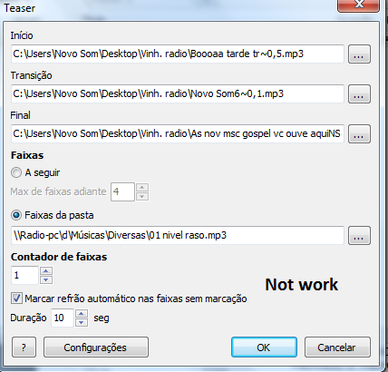

Good morning, there is a problem happening in the Teaser, I configure the input, transition and final all right, now if it marks a specific song to run the program hangs. The detail is that if it marks to take everything that is inside a folder yes yes it works. I am using win7 64bits
As an additional data I can say that when the program does not play (because it was not entered yet entered the configuration)
I found out what the problem is. It only occurs when the same output is also used for the assistant player. If I put the auxiliary player through the master output, everything works properly.
It could hang in older versions, do you use the latest RadioBOSSS 5.6.0.4?
It appears to be a bug, still (because it should work in any configuration) - will be checked.

I am using a latest available version 5.6.0.4
Thank you for the details - it appears that it does not actually hang, but pauses for couple of seconds. Will be fixed in the next update.

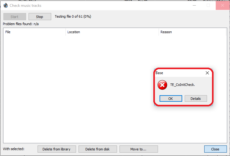

Cheshunt Radio said:
BUG? When checking tracks in Music Library I received this:
Yes, it's a bug - thank you.
