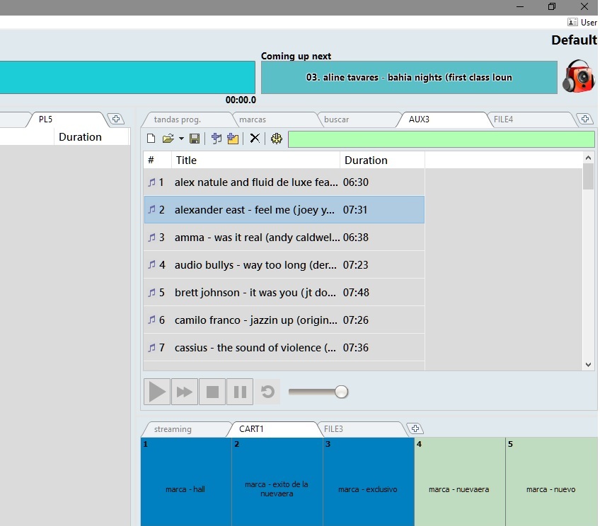

When creating an auxiliary playlist, I enter the files from a network address, it works without problems, then when I close the radioboss and restart it, the list no longer plays the previously entered files. If I re-enter files from the network to the auxiliary list, they do work until the radioboss restarts and there it will not play them again.
thanks by your attention.
Thank you for the details. We'll check if this is a bug. Meanwhile, you should be able to fix it if you mount network folder as drive and add tracks from there.

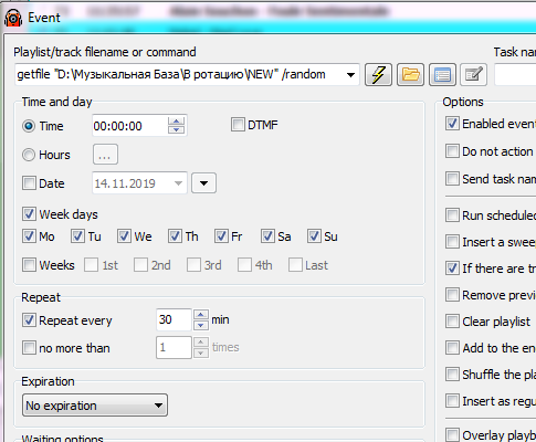

????? ??????? said:
Quests in section Several action, works only one thing ( screen higher
There is only one event action on your screenshot.
