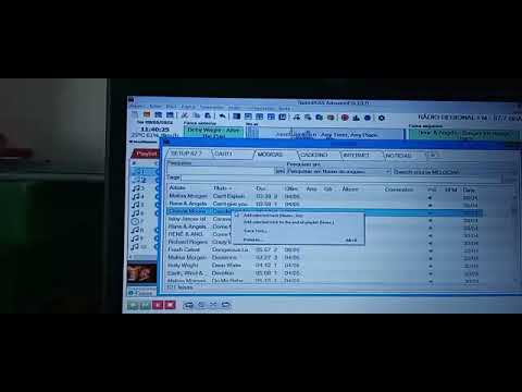

1-I use a lot of WORK AREA 5 (ADD).
SONGS, FOLDERS, BUTTONS AND OTHERS.
BUT... WHEN I CLICK TO LISTEN TO THE AUDIO WITH THE RIGHT BUTTON (PRELISTEN...) IT MINIMIZES THE DESKTOP AREA 5: ADD....IT GETS WEIRD.
I WOULD LIKE IT TO STAY AT THE TOP AND NOT MINIMIZE.
2- AD SCHEDULER, IF POSSIBLE IN THE FUTURE IN THE TAB, ADD THE PRIORITY OPTION.
THANKS.
Doesn't seem to happen here. To clarify, you use an additional work zone, and it minimizes the main RB window when you prelisten a track?
Do you use the latest RadioBOSS 6.3?
This only happens when you the "UI - Additional zone stays when main window is minimized" option is set to True. It's configured in Settings, General, "advanced configuration" button. You can set this to False to prevent Prelisten window from hiding the zone window.
NOW IT'S PERFECT.
THANKS!
