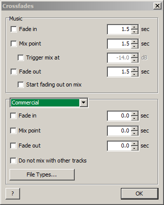

Can you please send a screenshot of Crossfades setup?
Done (all turned off). I don't think it's the cause, since in normal situation I will always set the Mix and End markers in the absolute end time of a track (or use a segue editor). Quick thought: wouldn't it be useful to have an option to add a flag 'do not mix' to the track in the playlist? (I don't mean setting a specific File Type or playing with the markers, but rather use it ad hoc in the playlist ie. right mouse click -> do not mix)
OK, I thought it could be that you use the "Trigger Mix" option, and it takes a while to scan a track, which could introduce a gap.
About the glitch. Do you hear the click if you start the second track? (not when it follows the first track, just play) You can also try setting a small overlap (0.1 s Mix point) to see if it makes things better. RadioBOSS is not designed for a gapless playback like this, to be honest - it always supposed to have a crossfade between tracks.
