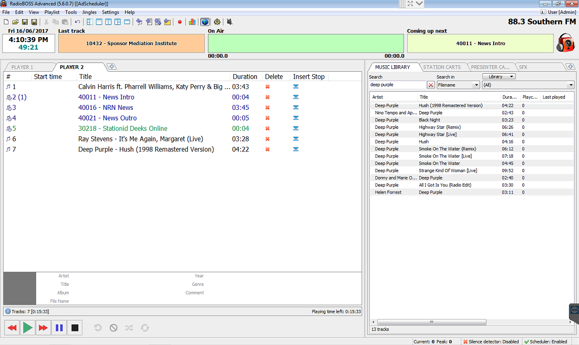

Upgraded the studio PC's from 5.5.4.0 to 5.6.0.6 yesterday. Whenever our scheduler imports a schedule to run, the first spot in the schedule plays twice before it moves on to the next spot.
Please send screenshot of the event that plays twice, also screenshot of the playlist will help.

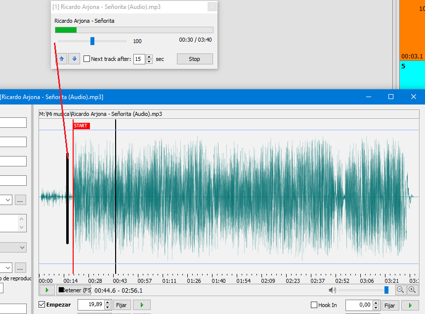

There is an error at the start point in the cue player.
Starts before the point started.
If you need I can send the song by mail
It basically came up with the (1) next to the first file that was due to play, played it, the (1) disappears, then it continues on.
I manually re-created the profile again, using the same settings that were configured previously. This seems to have resolved the issue for us.
We tried reproducing it here, but to no avail... A screenshot should help here.
Thanks but as we've resolved the issue we won't pursue a 'fix' for it. Basically a new profile created under the new version resolved the issue for us, so if anyone else encounters this issue that's the way to resolve the issue.

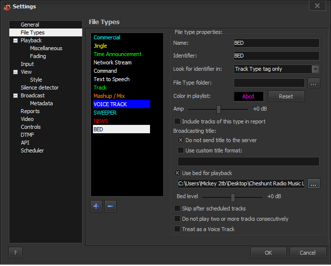

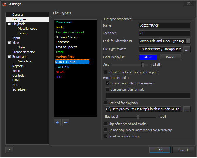

I seem to have an issue with "beds"
If I voicetrack, RB behaves exactly as expected.
If I add a "Bed" to the voicetrack and create a new filetype "BED", the bed continues to play after the voicetrack has ended.  I tried a shorter bed and it starts to play again over the next track.
Ensuring the "treat as voicetrack" tick box is unticked, the bed still continues to play. regardless of whether I have ticked the box or not.
Am I correct that the bed should cease as soon as the voicetrack has ended?
southernfm said:
The issue seems to have returned. I've attached a screenshot.
On the screenshot I don't see that anything's playing. The (1) is not a problem - scheduler sometimes adds the first track of the scheduled event to the playback queue to make sure that it will start when needed.
Yes, the bed should only play when the track is playing. Please provide more information on the setup - we'll try to reproduce it here.

I have Two file types  VT - and BEDS and this is reflected in the filetype  identifier VT & BEDS
Voicetracks work perfect - Starts and stops exactly where I expect it to.
The BEDS filetype is the same as VT filetype except "Treat as voice track" is unchecked (Expecting file to play as a jingle where the BED stops playing as soon as the voicetrack stops).
The BEDS filetype behaves like a voice track but when the VT stops the Bed continues to play over the next track. This happens whatever the length of the bed.  A Short Bed will recycle itself and continue to play over the next track.
The track plays, the (1) remains on the track while it plays the first time. The second time the track plays, the (1) disappears, but it is the second time it plays. It's in the log files as a double played track.
This is how it appears in the CSV
40011;News Intro;;16/06/2017 2:00:52 PM;;8
40011;News Intro;;16/06/2017 2:00:57 PM;;8
;40016 - NRN News;;16/06/2017 2:01:02 PM;;5
40021;News Outro;;16/06/2017 2:04:47 PM;;5
The news was scheduled to appear at 1:59:00PM. The schedule only has 1 'News Intro' 1 'NRN News' and 1 'News Outro'. Radio Boss plays the Intro twice then continues on. The first time it plays the news intro the (1) remains in the player, next to the 'News Intro' mp3. The second time it plays, the (1) disappears. In the past typically the (1) is visible up until the mp3 file plays and the (1) disappears straight away. At the moment, the (1) remains there, plays once, then plays again, the (1) disappears, then it moves on to the next file. It's double playing the first track/mp3 that is scheduled.
Downgrading to 5.5.4.0 gets rid of the issue. I tried creating a new profile but that didn't seem to resolve the issue.

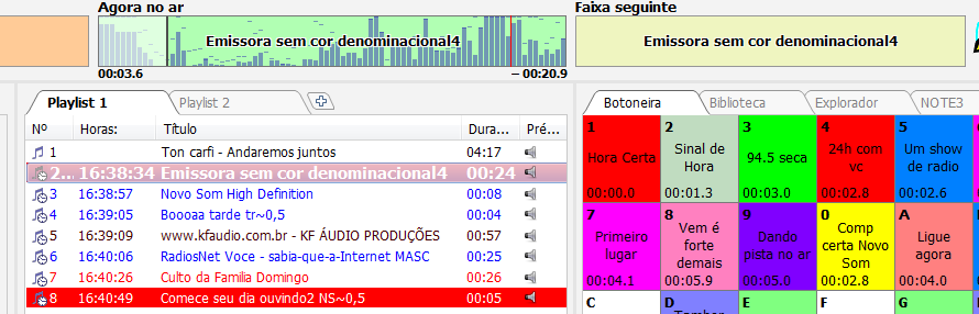

There is a problem happening when the list is stopped. Every time I manually execute the commercial block or other programming that is in standby mode and programmed not to play with the list stopped, it repeats the jingle block introduction. I am using version 5.6.0.7 and windows 7 64 bit

In fact, it is a similar error, I think what was lacking was detail to understand the problem. I am using the latest version 5.6.0.7. It's no use creating a new profile, I've done all the tests here and it does not solve. This error happens whenever the list is stopped, if we launch a scheduled event regardless of the type, it repeats, if it is a multi-action event, the program repeats the first audio and then follows the normal with the rest. In fact, any event launched from the event scheduler will repeat when playing if the list is stopped and we give play manually. I would if possible send a video to Dmitry.
Please post a screenshot of an event that does this, and also screenshot of player window - before and after an event is started. This is required to reproduce the problem here.
Also, to clarify when you say "Manual start" - does it mean that the event is started manually (the Run Now button), or that track in the playlist is started manually (using the play button)?
Update the bug was reproduced when the scheduled track is started manually from the playlist. It does not remove the track from the queue, therefore track plays second time. This will be fixed soon.
I'm still not sure how the two file types relate... I think more information is needed to understand what happens.
