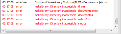

I'm having problems with the command makelibrary
The command is:
makelibrary Todo.xml | D: \ My Documents \ My Documents Nelson \ My Music
The XML name already exists so you should update your.
The path where to scan is correctly written
When path contains spaces it has to be enclosed in quotes, eg:
makelibrary Todo.xml|"D:\My Documents\My Documents\Nelson\My Music"

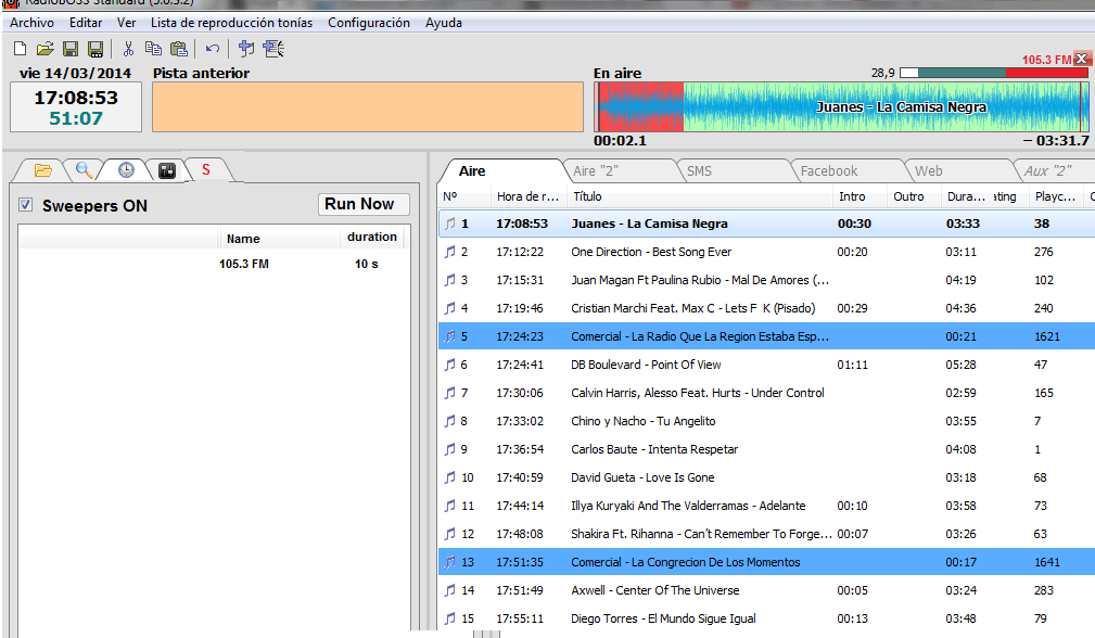

Here I attach a screenshot of my idea of ??implementation.
Songs that do not have intro points established, can not be played sweepers.
Always looking for a sweeper to be of size equal to or less than the intro of the song begins.
Never begins an intro before a song because it's longer. (as is the case voicetrack)
but any idea is welcome.
would be great if this can be implemented in RB 5.1! :D

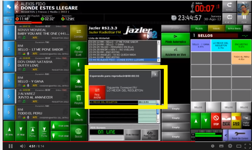

Here is a tutorial which shows the operation of this in Jazler.
http://www.youtube.com/watch?v=Z2mOdOkXcZk (Minute 4:20)
Yes, s similar idea is already planned, and I also added your comment there. There's a good chance that this feature will be included in RB 5.1
