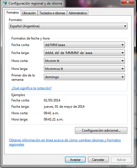

There is some text in the edit panel labels, not can see.
What date/time format are you using (regional settings in Windows control panel)?

I use the time zone of Argentina.

OK - the next update will have this problem fixed.

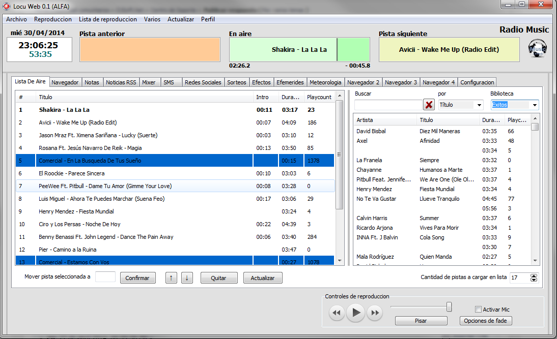

Hello, I have a request / improvement:
On Sunday afternoon I habilito one scpipt in PHP where users can program tracks, and these are automatically inserted in the list using the API RadioBOSS.
In ADS you see I have with Scheduler, scheduled announcements.
The other day I noticed that after that automatically insert advertising began to insert songs from the api, and this causes that advertising does not play when I should.
I've been thinking and this would be solved with a new api command "Insert after queue" then songs always be added after the advertising.
