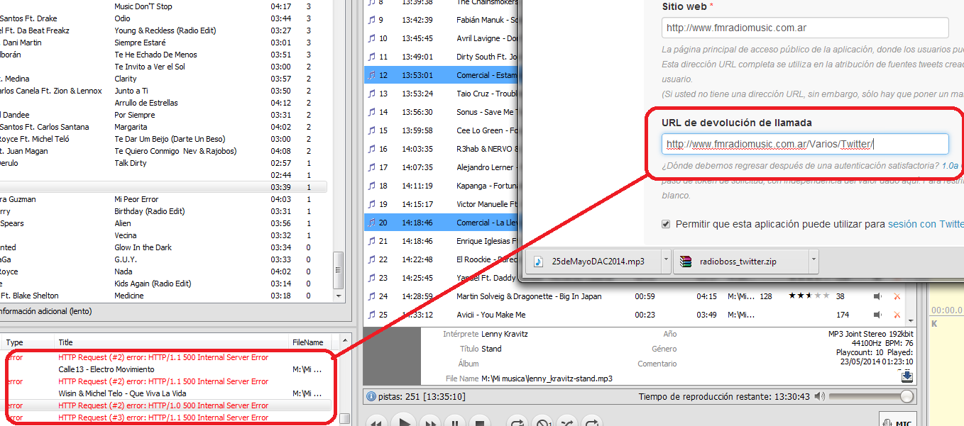

Hello I put that URL for redirrecion twitter?.
In radioboss 500 error appears.
What URL you're using in RB notification settings?
I tried your site server as shown in the example.
and also with my own server (I went there the files attached)
www.fmradiomusic.com.ar/Varios/Twitter
You should try with our hosted script first, just to make sure things work as they should.

I try, but it was the same problem in radioboss.
Make sure you have created the Twitter app exactly as shown in the first post. Pay attention to: the app has to have write access and also make sure all access keys are correct and that keys have write access too.
