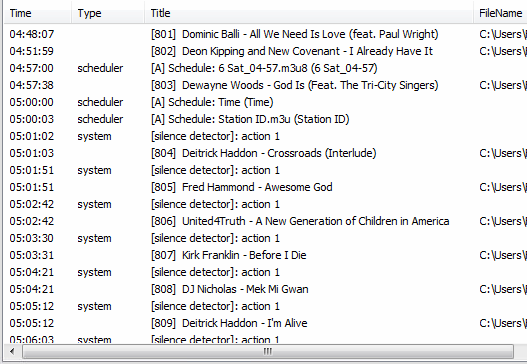

We have the time announcements and then the station id that runs right after it. there is like three seconds between the time annoucement and the station id in the schedule
First time you've said that time announcement freezes the player - do you mean that it freezes it for 3 seconds?
Another question - this is an automatic time announcement or just an mp3 file?
[/quote]
no, no the player freezes and doesn't go away so nothing else plays not even the playlist. This is the automatic time announcement i downloaded from the link on the website.

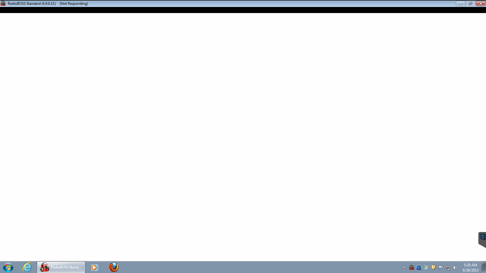

If you manually start the time announcement event, will it freeze? Also try adding time announcement to the playlist and start its playback, let me know if it freezes there.
no it doesn't freeze only in the overlay player. It actually freezes at 5am from what i am seeing. Every morning at 5am the overlay player just doesn't closes out and hense it doesn't return to the play list. RB just stop playing until I go in and click cancel on the player then everything starts working anything until the following morning at the very same time again.
OK. Can you please show a screenshot of an event which starts the time announcement?
This is one of the errors i get when the time announcement runs.
Looks like it's completely frozen.
