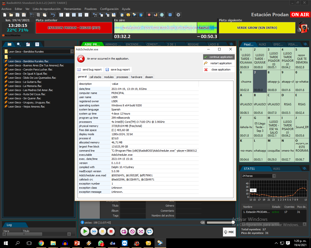

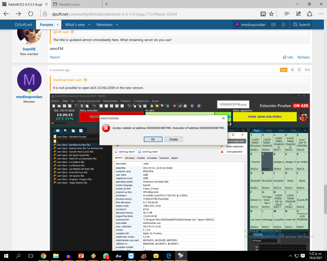

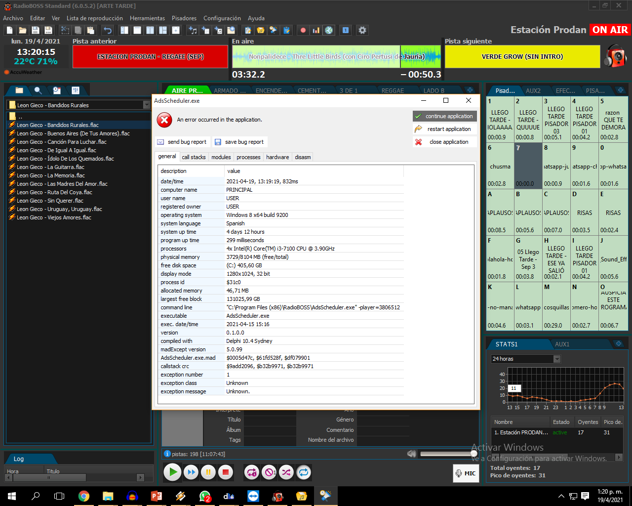

It is not possible to open ADS SCHELUDER in the new version.

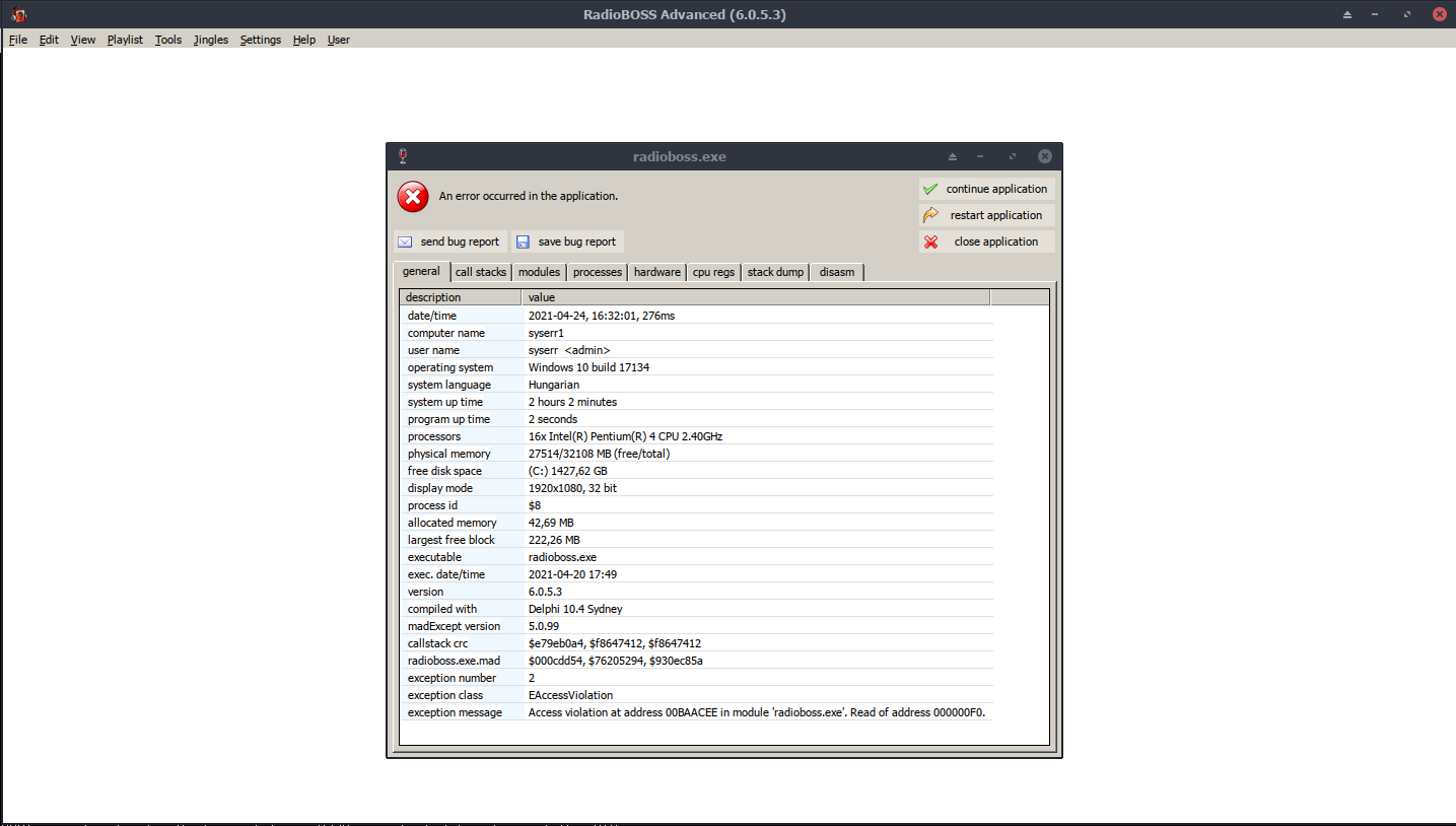

RadioBoss Errors 6.0.5.3. Drag tracks up to position 50. Flashing Events and Cover Sheet.
Thank you, we'll check what could be wrong there.
Regarding the flashing cover art, please do the following: open Settings, General, Advanced configuration. Set "Playback debug log" to "True" and restart RadioBOSS. Wait for the flashing problem to appear. Then click Settings, Open Settings Folder. Open Logs folder and send us the "playbackdebuglog.txt" file to support@djsoft.net

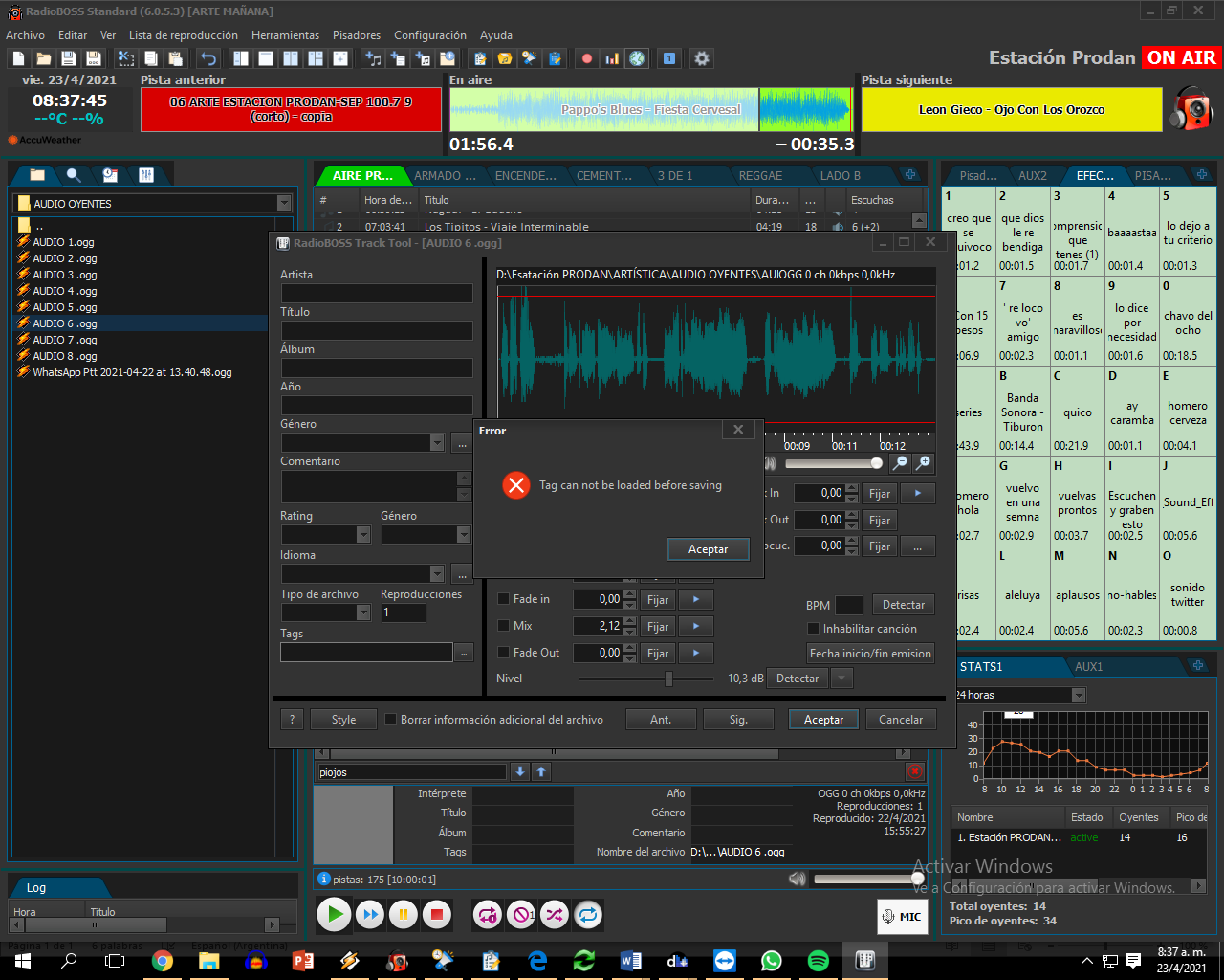

RadioBoss Errors 6.0.5.3. Track Tool throws an error when wanting to modify .OGG files
This file could be corrupted. If possible, please send it to us for testing support@djsoft.net
