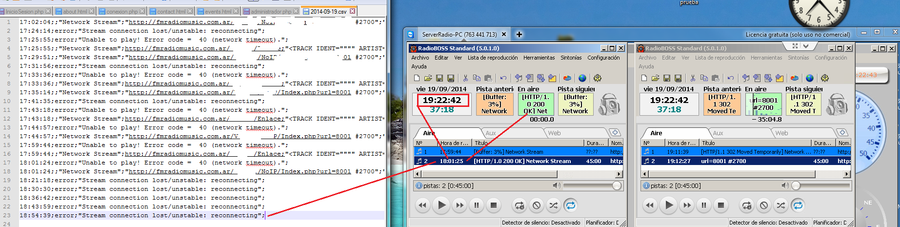

Here a broader description of the problem.
It is all due to internet problems but RB does not respond as it should.
You can see in the screenshot that RB is approximately half an hour trying to upload streaming.
When reconnecting a streaming "time out" does not work (this is a bug).
As the silence detector was never disabled runway change.
But my problem lies in that I could never detect this cut in transmission.
I have an installation of RadioBOSS apart, with another internet connection to be assigned alternating for cuts. (the volume of a body is lowered and raised to the other)
One way to detect that a court is "Network Stream", but never here my FM radio then fell silent I wrote !.
To simplify things I think as above an option to disable pedi reconnections for tracks with an established duration, with all the problems I simplify this.
So here I am waiting for the RB 5.2 Beta, where you said you would provide me a solution :)
