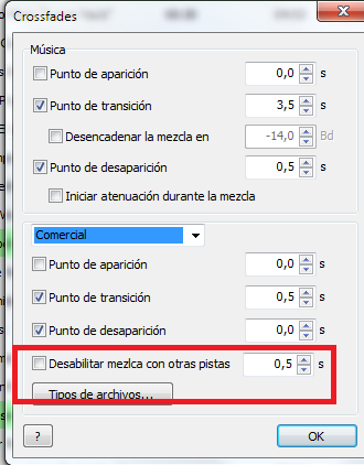

Hello Dmitry.
I would have a control to set the mixing time, from an earlier song to a file type.
Many times when mixing times between songs is very large, a song about a jingle overlaps.
Fortunately this the "Do not mix with other tracks" that solves the problem completely removing the mixture completely. still a very small mix would sound more professional.
So I would like to have an option to define a mixing time that precedes a file type track.
Is it possible to implement this?

Hello Dmitry.
Noted, thanks. Will be implemented in one of the next updates.

Hello Dmitry.

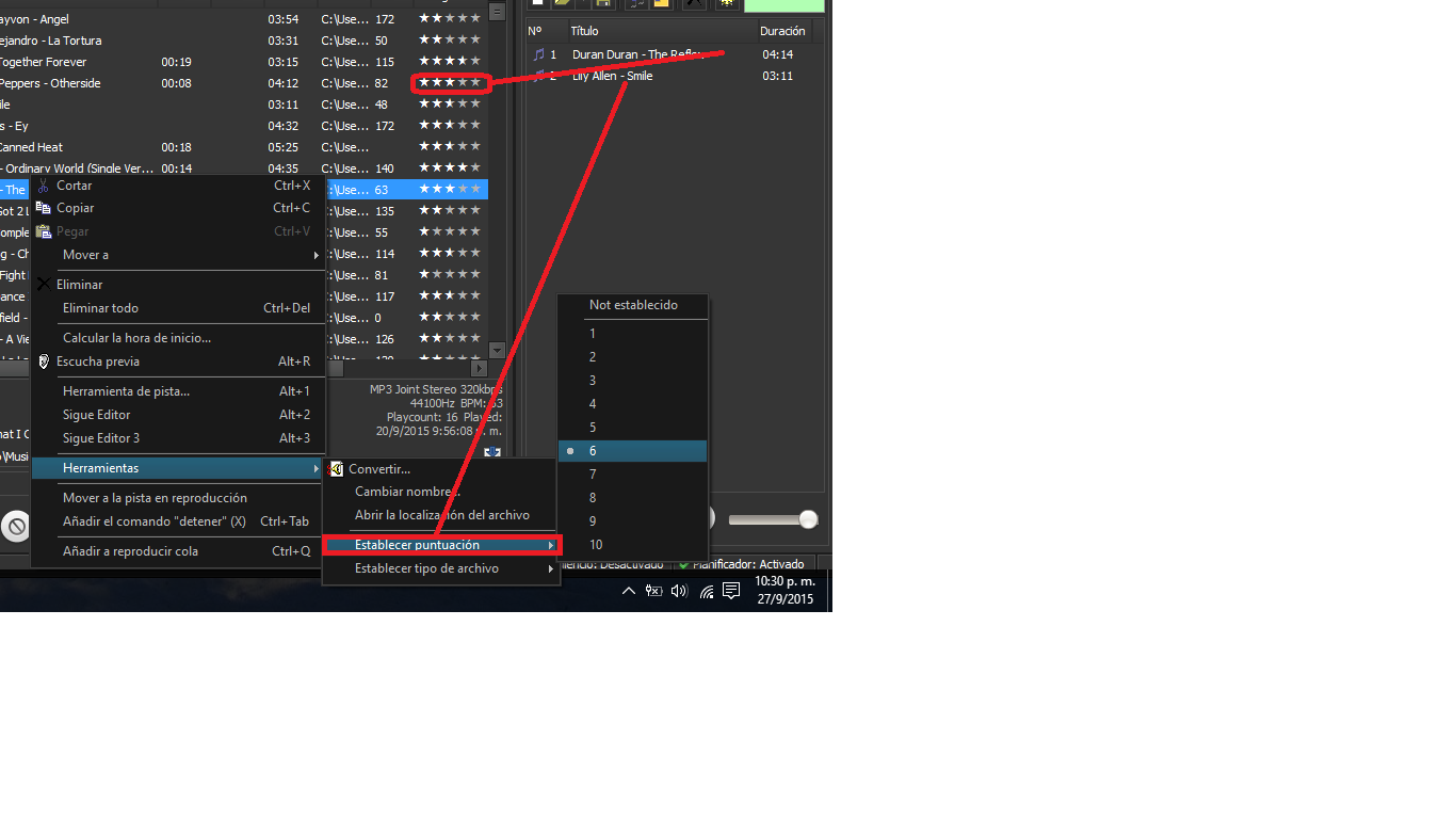

Another feature that I like for RB 5.4 is to see the priority in the list of the players aux.
Can you please provide more information on how should it work?
and also to change it with a right click (as the master lists of RB), without having to go to Track Tool. This feature is very practical.
And more information on this one too is required :)
That's great!.
I think that with this image will be enough. :)
I can't wait for the Beta release. :D
